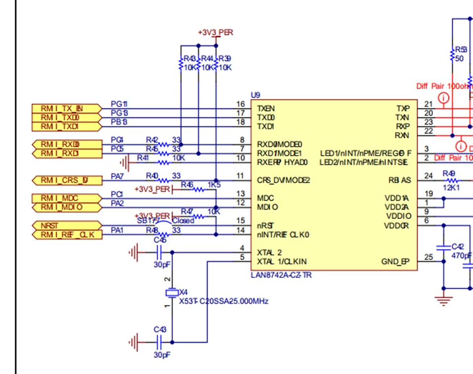

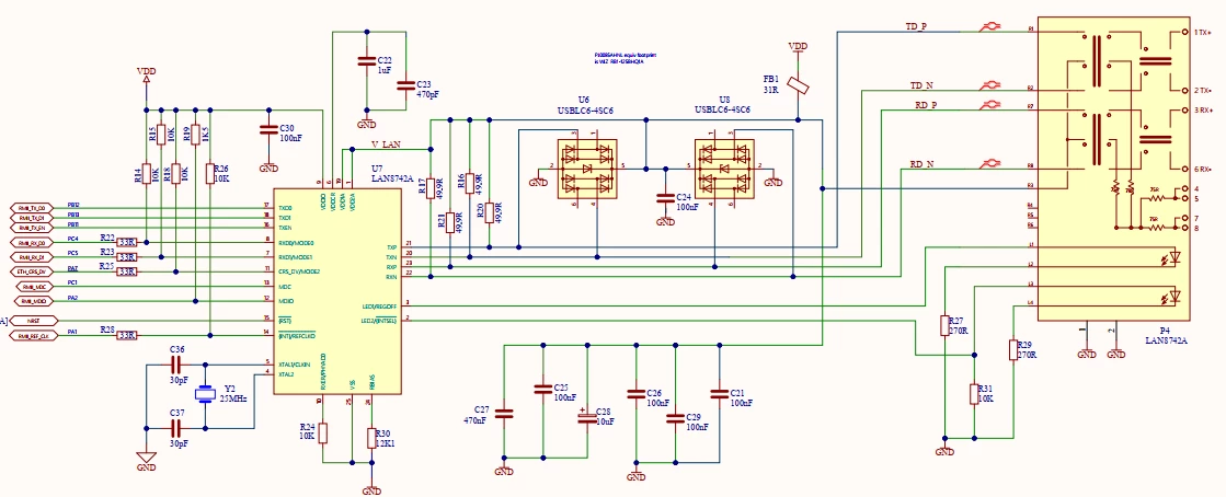

I have designed an ethernet interface  for an F746-100 MCU
I have changed pins to avoid using Port G and I have used the  circuit below.
The RJ45 connector is a standard RB1-125BAG1A and the ethernet chip is a LAN8742A
Can anyone tell me if there are any mistakes in this?
I cannot get any connection at all - F746-100 will not ping.
Green LED ON and Yellow LED flashes continuously.
I have an STM32F746 - 144 Nucleo with the same software (apart from the two pins that are changed) -works fine.
The 25MHz xtal works OK (same signal on both boards) and the LAN8742_STATUS_OK returns 0  on both boards when I debug.
There appears to be no errors in the setup LAN8742.c or the ethernetif.c when I debug. This code works OK on the NUCLEO board and I can display a small webpage. Both sets of code use only ETH and LWIP, fixed IP, on a standard Cubeide setup. I assume that the only difference is the two GPIO allocations (PG13>PB12 and PG11>PB11) which I have altered in software.
I have the same sort of signals on both boards on TXP/TXN/RXP/RXN
Can some kind soul tell me if there is anything obviously wrong with my hardware?
Thanks.
Chris
clock.1166
clock.1166Best answer
Senior
Feb 1, 2024 2:55 PM UTC
JOY of JOYS!!!
A *** mistake -
4 resistors on Ethernet circuitry were incorrect.
I am not too familiar with SMD markings, and I wrongly assumed '4992' was 49.9 ohms, when in fact they are 49.9Kohms.
It was not possible to measure them on the board since they were across a coil.
I replaced them with 4 standard resistors and ethernet works OK!
Thank you all so much for helping me.
The circuit and the project I uploaded are guaranteed to work, so hopefully this will help others.
Chris

clock.1166
Senior
Jan 30, 2024 8:31 AM UTC
Thanks STea/Stone-32,
I have placed (I hope) a better image of my circuit. Any suggestions would be helpful!
I have a feeling that this is the source of all my problems, although I dont know enough about LWIP and ETH to be certain.
I cannot find any similar project using STM32F746-100. It would be helpful if I could.
1. I compared the clocks from an STM32F746 nucleo (which works fine with the same basic software) to my board with a scope. The reference clock(50Mhz) and the xtal clock (25Mhz) looked almost exactly the same - 25.010 and 25.1 MHz - same amplitude. The signals on TXP/TXN/RXP/RXN also  look the same.
2. Yes -  GPIO's set to very high.
Simple webserver for Nucleo F746 generated from cube IDE attached (http://192.168.1.218/)
F746-100 generated same way - obviously ETH pins are slightly different.
I will work on the other questions today.
Thanks.

clock.1166
Senior
Jan 30, 2024 10:35 AM UTC
Possibly slightly better image?
clock.1166
Senior
Jan 30, 2024 3:06 PM UTC
Hi STea,
Answers to your questions:
  1. verify if there is a change in the VDD level between the two boards . ** NUC VDD 3.3V    F746-100 3.27V
  2. check if you can visualize the signals from the TXD0 and TXD1 to see if there is traffic between the MCU and the LAN8742A ** Scope shows no signals on either, but there are signals on TD_P/N and RD_P/N
  3. try to read the status of  LAN8742A with the help of the init function api in LAN8742.c in run mode (toggle an LED when LAN8742_STATUS_OK returns 0 ) ** Always returns 0 -OK
  4. the RST pin in your design seems to be not connected can you give more info on it its not clear in the   picture ** ** Connected to 47K to VDD and 100nF to ground and MCU NRST pin. N/O switch to ground.
  5. can you give us information about the clock source feed to the MCU . **Looks fine - 50MHz 4V peak to peak sinewave.
Thanks again.
