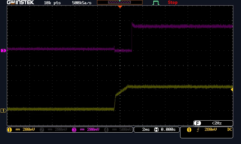

The first idea was that there is a power issue, but I set the Brown Out Reset level in the option bytes to around 3V. Looking at Vin (3) and Vout (1) of the regulator, voltage seems to be fine. (2) is the output of a GPIO output which was initialized to HIGH in MX_GPIO_Init() -- but it remains LOW, which means the program is not executed.
0693W000006GWLqQAO.pngThe duration until the voltage has risen to 3.3V is more than 1ms, but according to the datasheet the rise time doesn't matter (if it's not too short).

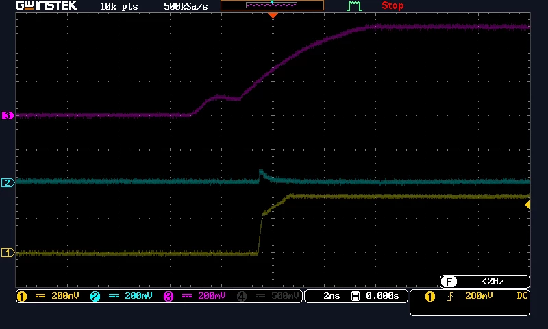

Looking at the NRST pin (with only a 10K pullup attached, but no flasher device), this is curve (3) while (1) is Vout, i.e., Vdd of the STM32.
0693W000006GWNXQA4.pngThe increased BOD level seems to work; the STM32 starts working after the voltage is stable.
Thus, the voltage doesn't seem to play a role in the STM32 not starting up. What else could prevent a startup?
