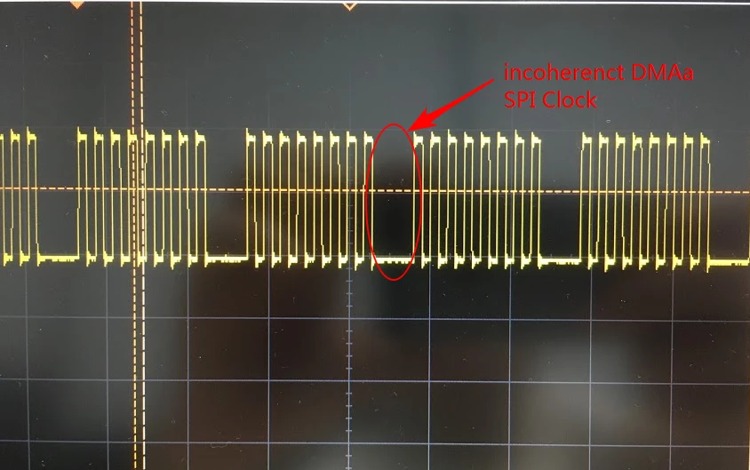

STM32F746 DMA SPI's Clock is incoherent
  • August 7, 2017
  • 4 replies
  • 2405 views
Posted on August 07, 2017 at 16:34
As the title says, the clock's wave is as below for DMA SPI2's Clock:
My DMA SPI Setting is as below with red color:

If there is anything wrong with my setting?
So is there any method to remove the  incoherent SPI DMA clock.

Posted on August 07, 2017 at 18:41
>> incoherent
Discontinuous?
Make sure the data widths match.
TX side drives clock in Master mode, review Tx DMA, use FIFO and high priority settings?

I would advise to check SPI 4 wires example code in Cube from the nucleo or discovery of an STM32F7.
When using SPI, the DMA TX and corresponding block size will drive the clock. Maybe the DMA is transferring blocks of 1 byte, or, because the time scale is unclear, other higher priority tasks/DMA are running in the background (unlikely). Make DMA priorities to be sure. You send a byte, you later get a byte.

I fix the issue by modifying SPI2's TIMode setting from:(disable -> enable)

The Clock is continuous, but the clock number is not correct and data is also changed.
So Why the gap between byte of clock disappeared after I changed to TI Mode???

The right way to fix this issue is to disable NSSPMode as below:
