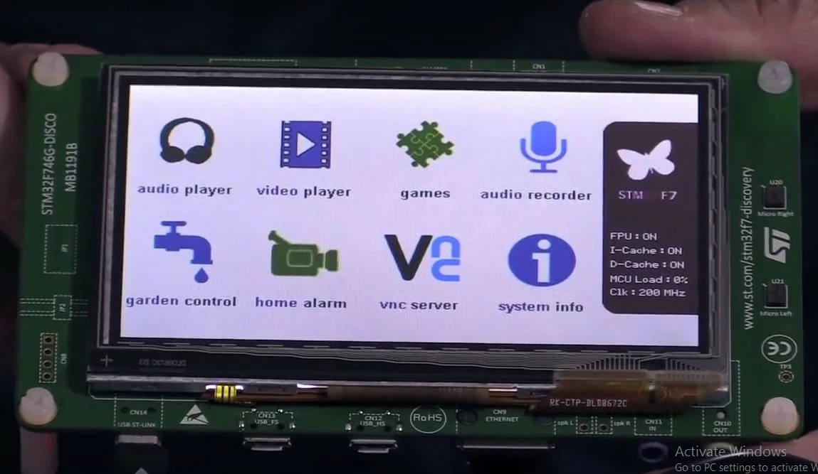

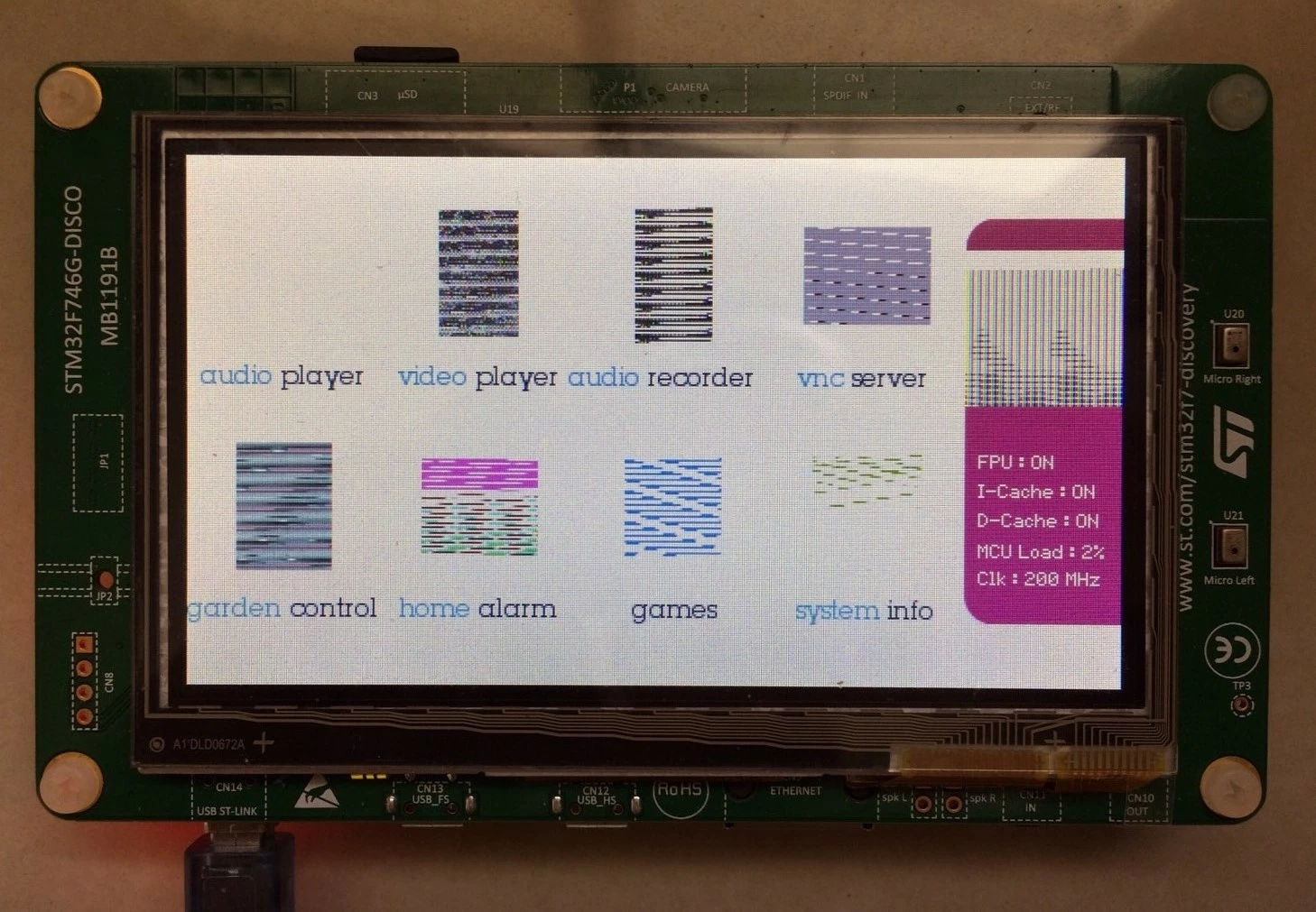

Dear All.
I try to complier sample code from st at D:\STM32\STM32F746NG\
STM32Cube_FW_F7_V1.7.0\Projects\STM32746G-Discovery\Demonstration\
MDK-ARM
On sample video from
https://www.youtube.com/watch?v=R78zvO-s6H0
but on complier and run sample code. quality not same. maybe need to modify some setting in coding.
Have someone can help me to fix this issue.
Thank you.

    Max
    August 22, 2017
    Posted on August 22, 2017 at 10:59
    The graphical elements are missing from the QSPI memory in your case.
    The easier way to upload them is to use
    http://www.st.com/content/st_com/en/products/embedded-software/development-tool-software/stsw-link004.html
    and to enable the QSPI external loader  (external loader menu -> N25Q128A_STM32F746G-DISCO)
    Follow the instructions from the readme file in the root of the demo project

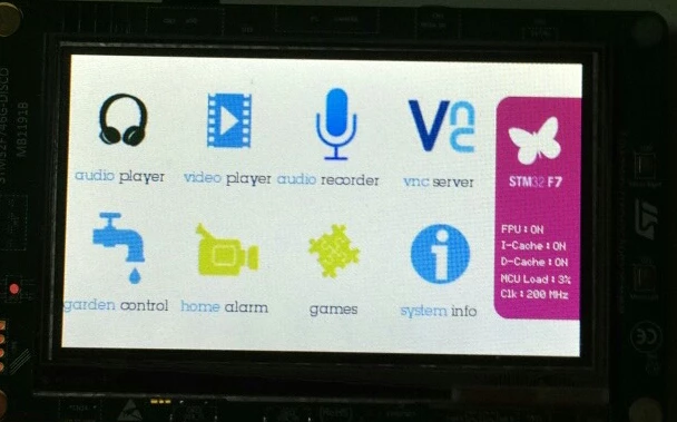

    Max
    August 24, 2017
    Posted on August 24, 2017 at 06:41
    This HEX file also contains the data for the QSPI memory.
    This is exactly what you are missing right now.
    In order to program it, you must enable the flash loader so STLink utility can program it.
    Keil (or any other toolchain...) cannot do that.
    Once it is programmed you can use your own compiled version: You can modify it and debug as you like.

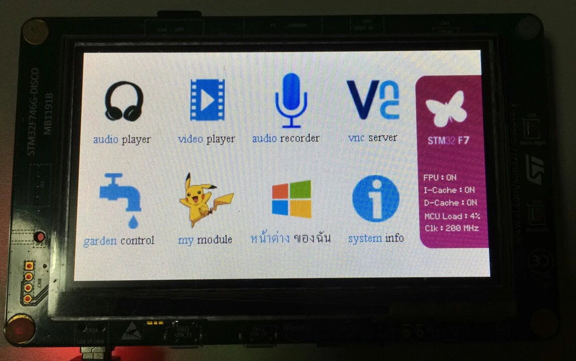

    Thanormsin Makthong
    August 28, 2017
    Posted on August 28, 2017 at 15:58
    After try
    Right now. Pic display correct.
    and I try to test modify some icon and change to thailand language
    Thank you for help
