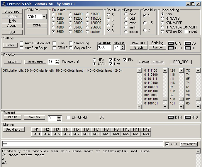

    Posted on June 26, 2017 at 14:55
    Found a small error in code (and modified the starting post, see //here it is! ) and everything seems to be working. That error was not related to the issue, but it works now...
    I'll ask here if something changes, Okay?

    Posted on July 04, 2017 at 16:56
    Seems like I should Initialize GPIO before setting up any UART clocks:

    Transmission works, reception does not work.
    Defining interruptions is required to getthings better. One should define also this codein stm32f7xx_it.c :

    Posted on July 05, 2017 at 09:09
    Interrupt handler is being called twice more than the actual number of recieved bytes. Here's edit to make it called exact times:
