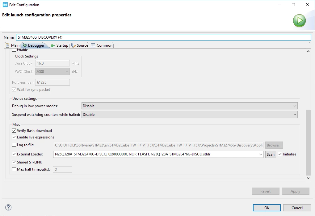

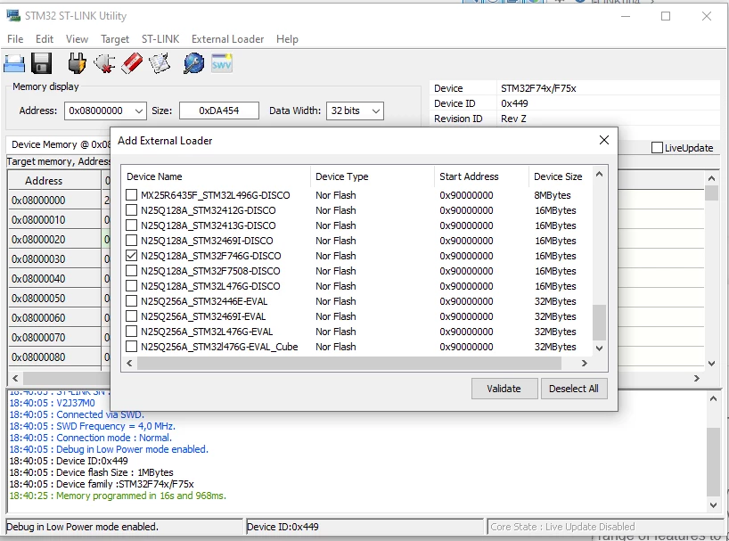

and this setting N25Q128_STM32F746-DISCO

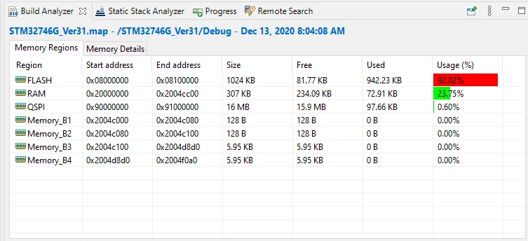

the compile phase now it is ok
I see the QSPI data in the STM32746G_Ver31.map
but I get the error during the flash phase of the external QSPI

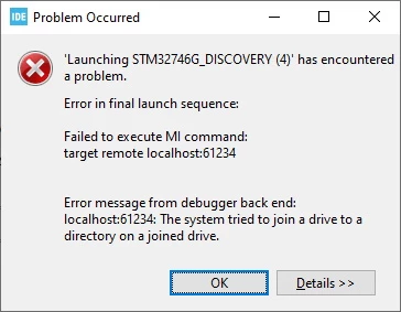

STMicroelectronics ST-LINK GDB server. Version 5.7.0
Copyright (c) 2020, STMicroelectronics. All rights reserved.
Starting server with the following options:
 Persistent Mode : Disabled
 Logging Level : 1
 Listen Port Number : 61234
 Status Refresh Delay : 15s
 Verbose Mode : Disabled
 SWD Debug : Enabled
 InitWhile : Enabled
Failed to initialize external memory!
Error in initializing ST-LINK device.
Reason: Unknown. Please check power and cabling to target.
 solved with ST-LINK Server and this settings

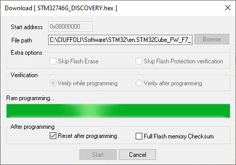

Using the ST-LINK outside the CubeWorkspace it run
0693W000006FZNTQA4.pngand I see the value "pippo"
