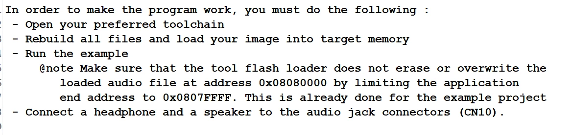

STM32F746-disco project: How to limit the application end address to 0x0807FFFF?
Hi all,
At the bottom of the readme file for the BSP project for this board says:
 How do you limit the application end address?

In the linker script, set the FLASH section to be 512kB in length:
/* Memories definition */
MEMORY
 FLASH (rx) : ORIGIN = 0x8000000, LENGTH = 512K
