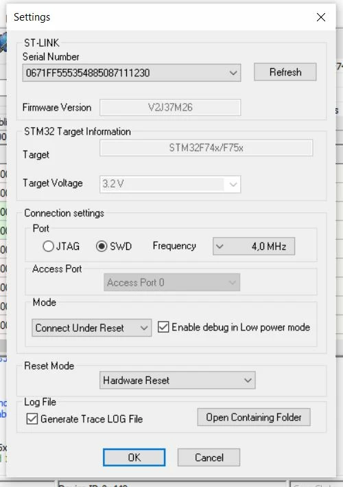

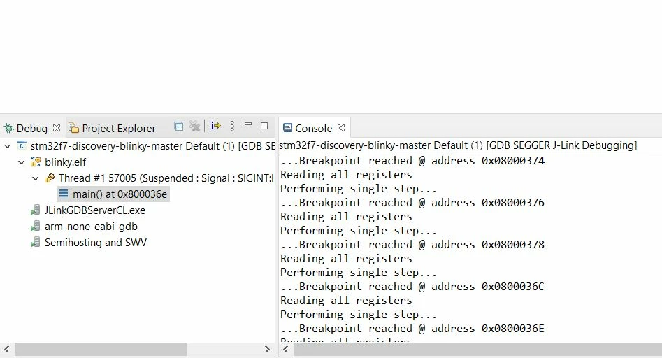

Mario Ghecea
Oct 16, 2020 12:59 AM UTC
It does not work in Segger J-Link OB either...Seems once again ST Sold a $70 dollar board without single stepping ability so shifting blame to Segger is a poor implementation of a joke without re-spinning the Silicone...It only works by using the ST Link Utiliy in a special tweaked mode...Open OCD does not work using ST Link or upgrading to Segger. It cannot step as specified above...Single Stepping fails completely in Segger J-Link OB by jumping steps because it cannot stop on a breakpoint and runs hay-wire...Same deal with ST-Link...Sad as it looked like a promising board! Unfortunately it is Junk in any debug mode and I have tried them all...0693W000004JyjtQAC.jpg0693W000004JyhiQAC.jpg

It is an ARM issue, which they resolved in subsequent spins of their deliverable IP. ST was one of the first companies to get ARM CM7 silicon for them to work with.
ST isn't going to do-over the chip layout and validation, the design team(s) rotated into the next products, it is out of the design cycle, and into the fab/production cycle, and it will be there until end-of-life. Its not a process of constant introspection and correction of a design that's already left the factory.
If you really need to single step your code to understand flow/dynamics then you'll need to pick a part which is a close proxy or use more classical analysis methods.
