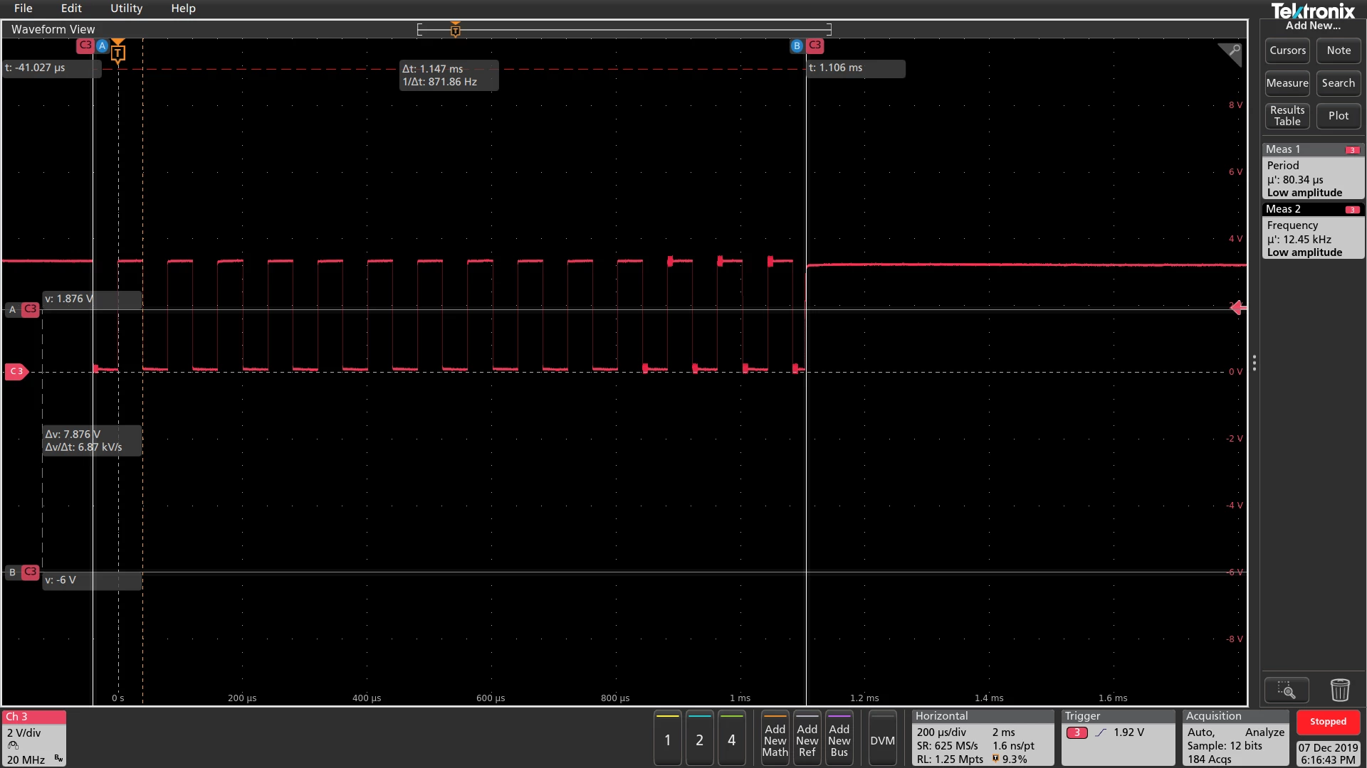

STM32F745 IWDG Refresh Problem when IWDG_RLR is less than 4
Dear All,
I am trying to use IWDG for STM32F745 and I did actually. I used CT Cube MX to configure it. Prescaler is 4, Window is 4095 and RLR is 3. I checked clock configuration and IWDG uses 32kHz RC internal oscillator and count down from RLR. I expect that when the downcounter reaches zero it will generate reset unless if IWDG doesn't refresh before it reaches zero.
32kHz with prescaler of 4, IWDG clock period is 125us.(?) If RLR is 3, I have to refresh IWDG before every 375us.
Note: I also developed code for STM32F334 and same configuration works well and I checked both user manuals are almost same. I supposed that IWDG would work easily with same configuration.
I have an ADC Interrupt Subroutine (ADC_ISR) and it hits every 40us. IWDG is refreshed inside ADC_ISR. I use one of GP Output to observe when ADC_ISR is serviced. The GPO is toggled at the beginning of ISR before refreshing IWDG. A part of ADC_ISR code is given below:
void ADC_ISR(void)
   HAL_GPIO_TogglePin(Diagnosis_Out_GPIO_Port,Diagnosis_Out_Pin);
   __HAL_IWDG_RELOAD_COUNTER(&hiwdg);      // To prevent reset caused by IWDG (Same action of HAL_IWDG_Refresh(&hiwdg);)
   Counter++;
When RLR is 1, 2 or 3, microcontroller resets itself even _HAL_IWDG_RELOAD_COUNTER(&hiwdg); is called every 40us. If the RLR is 4 or more than 4, microcontroller works as what it should be.

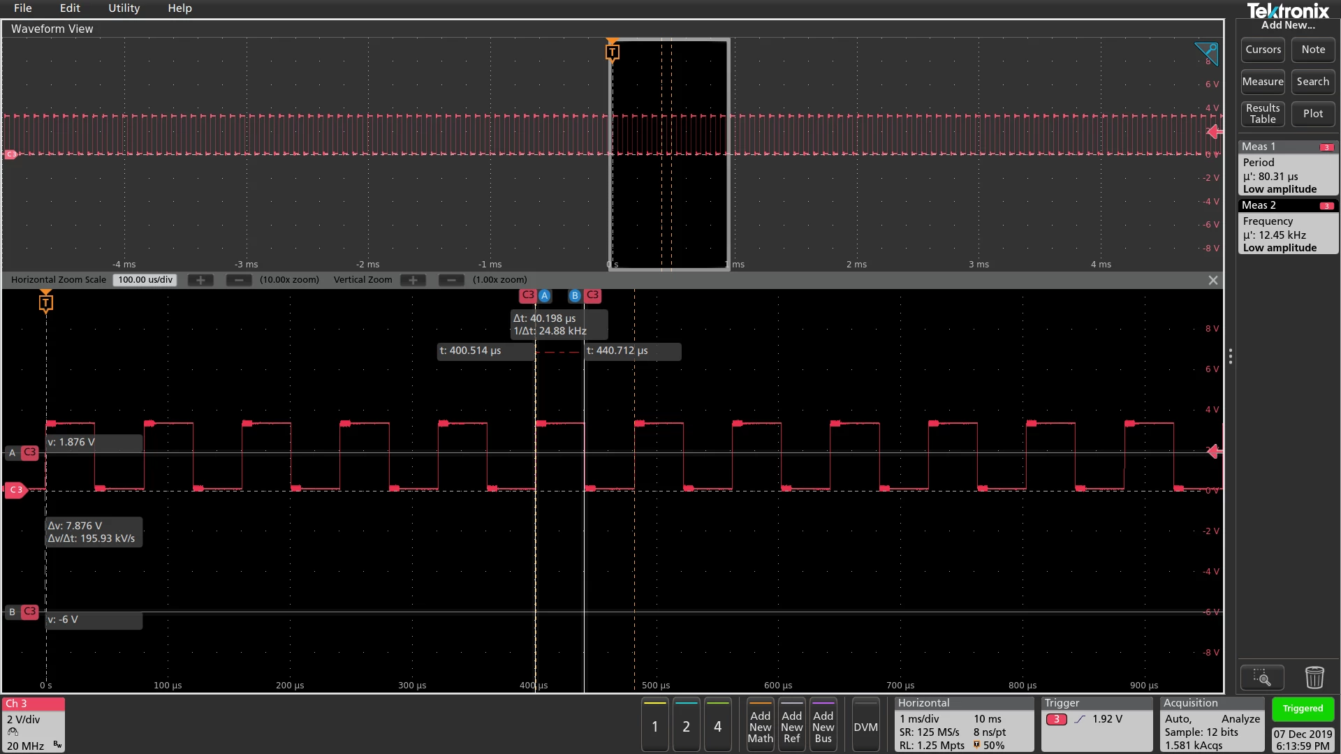

Please find scope screenshots. Figure1 shows Diagnosis output pin, it changes 30 times and after that the microcontroller resets itself where RLR is 3 and IWDG refresh is called every 40us. Figure2 is shows Diagnosis output pin again, where RLR is 4 and IWDG refresh is called every 40us. It is clear to see, if RLR is 4, microcontroller doesn’t reset itself and works as desired.
Please consult me where is the problem… For my code RLR should be 1, but I cannot set it less than 4.
Thank you very much in advance

Maybe this https://community.st.com/s/feed/0D50X00009XkW4gSAF is relevant and explains your findings - I don't know as it's a different STM32 model.
(This is the thread linked from there https://community.st.com/s/question/0D50X00009XkYEQSA3/iwdg-short-period-125-us-problem )

I don't know what to say... It would be great if it is mentioned in the RM or the Errata Sheet... If I understand well, there is no any workarounds if we are not happy with 500us reset period...
Thank you very much

Well, according to what I said there, 40us refresh should be fine with RLR=3 as it should guarantee several "kicks" out of the "guard" time of 3 LSi cycles - so either you're hit by some different issue, or the 'F745 indeed has such a "guard time" but it's longer than with the 'F4 I used.
As you've said yourself:
ST's comment would be nice, but I wouldn't hold my breath. You may want to contact ST directly, through the web support form or through FAE.
