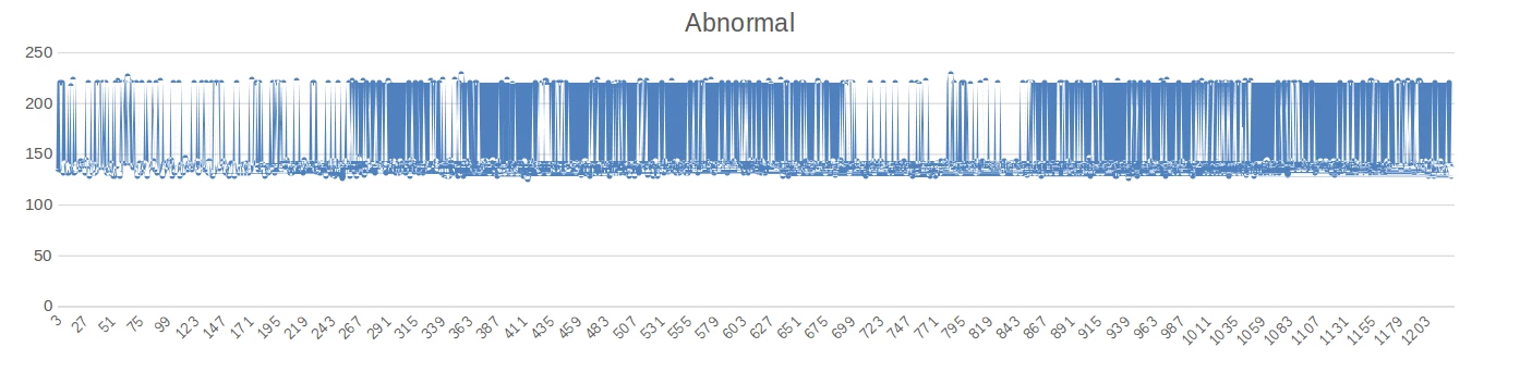

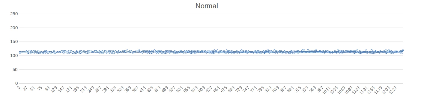

We did an experiment to measure wake-up latency. Using GPIO to generate pulses and measure the pulse width as wakeup latency time. As you can see in the image below, "Resume" is line 5 of the above code.
0693W00000QLiekQAD.pngWe have 10 custom boards. 7 of them look normal and the remaining 3 look abnormal.
Each board is measured about 1000 times and the results are converted into a graph.
The following graph is normal case, the horizontal axis represents the number of tests, the vertical axis represents time (100 = 1mS). Regarding the normal case, we could focus on two things, the first one is baseline(around 1.2mS) and the second one is the wakeup time stabilization.
0693W00000QLjOsQAL.pngThe following graph is abnormal case, you could observe that the baseline is around 1.4mS and the wakeup time is not stable.

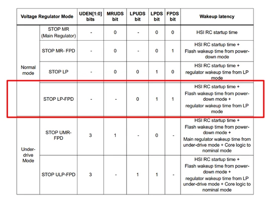

0693W00000QLjV5QAL.pngWe checked the datasheet, regarding the wakeup latency, it requires additional start up delay time:
  1. HSI RC startup time
  2. Regulator wakeup time from LP mode
  3. Flash wakeup time from power-down mode
  4. Re-configure the system clock
0693W00000QLjVuQAL.pngThe above additional startup delay time seems to be related to MCU internal resources. We don't have any idea about this issue, do you have any suggestion for us?

I don't know the F732, so for reference I checked the data-sheet of F767. That says wakeup from stop mode is typically 104 - 113 us; max 107 - 120 us (if we ignore the case where LP regulator is on, which is only circa 20 us).

Do wade through the source-code. I find the "bimodal" graph suspicious - it either seems to be 130 or 220 counts, as if the code sets something going, then only checks if it is actually working periodically.

Please try re-ordering the code so you drive the GPIO before configuring the clock. That would show if the delay relates to the startup of clocks or the execution of the Arm core.
