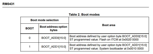

STM32F732 BOOT1 pin
I thought the BOOT Modes used BOOT0 & BOOT1(PB2) pins
and to pull BOOT0 (high) and BOOT1(low) to get BOOT MODE (SYSTEM MEMORY) and allow the STM32CUDE programmer!
I've looked thru the STM32F723 Docs and PB2 does not seem to show/share
the BOOT1 pin functionality.
Any Thoughts !
Chuck

It doesn't have a BOOT1 pin, perhaps you're thinking of the older F1 devices?
https://www.st.com/resource/en/reference_manual/rm0431-stm32f72xxx-and-stm32f73xxx-advanced-armbased-32bit-mcus-stmicroelectronics.pdf
BOOT0 = 0 / LOW - USER CODE
BOOT0= 1 / HIGH - SYSTEM LOADER ROM
You should pull down the BOOT0 pin to ensure normal operation of custom board designs
0693W00000aJaizQAC.jpgThere may be additional options in Option Bytes

Yes we do this on may of our designs..
My issue is with the STM32F723 Docs
typically PB2 is listed as BOOT1 but the 723 docs do not mention this pin as and ALT function...

Cite the actual document, I'm not going to go fishing for it, pretty sure the Data Sheet and Reference Manual don't mention BOOT1, I searched through them this morning.

Thanks......I've come to the same conclusion....NO BOOT1
