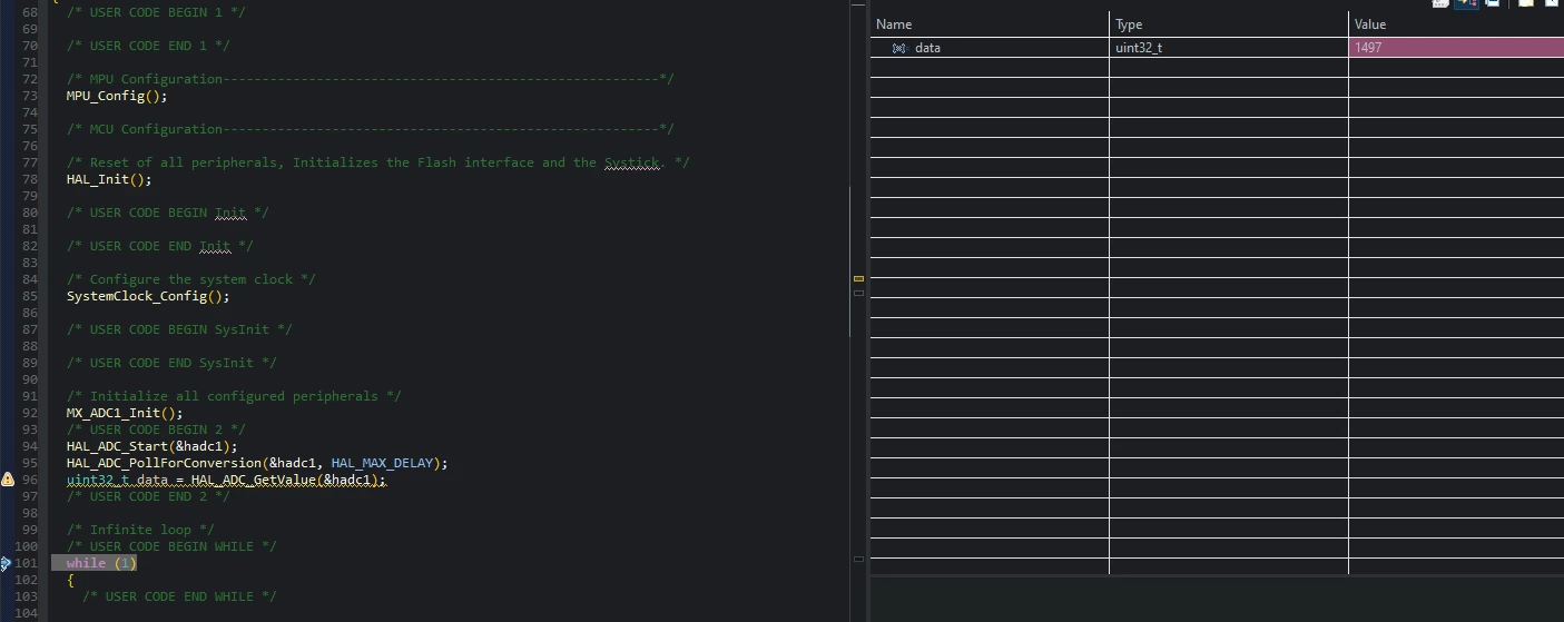

we want to read VREFINT to make our ADC measurements more accurate.
But the EOC bit is never set when selecting the ADC_CHANNEL_VREFINT channel.
PCLK2 is at 108MHz but ADC prescaler and sampling cycles are at max. so we assume there is no problem with the min. 10us sampling time.
The code below works for normal channels.

Here how we call MX_ADC_Read.
uint32_t val;
if (!MX_ADC_Read(&hadc1, ADC_CHANNEL_VREFINT, &val))
 Error_Handler();
Any idea what the problem could be?

Thanks for the tip, but unfortunately this results in an infinite loop. At least EOC was not set even after 2 minutes.
Senior III
April 27, 2023
It's weird. I have nucleo F7, set 108 Mhz , 480 cycles and others like you and works without problems. Maybe share your code?

I have enabled DiscontinuousConvMode and reset the sConfig every time, but unfortunately no success.
I can't share the source code here.
But I created a minimal example with CubeMX similar to @Kamil Duljas​ and with this it works.
I will now compare the two projects and get back to you if I find the cause of the problem.

Now it works!
I have found two errors:
1. __HAL_RCC_ADC1_CLK_ENABLE() was not called. So ADC1 never worked with my posted code, I confused that with ADC3
2. There was a wrong configuration in SystemClock_Config() because the code was ported from an STM32F722 which used some other peripherals. This somehow never caused problems until now
Thanks again for your help!
