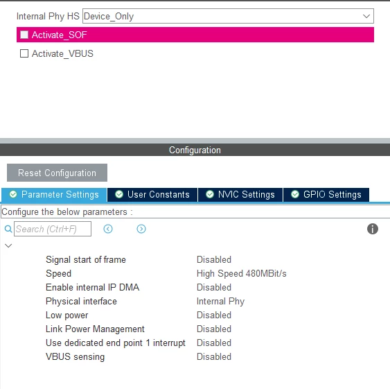

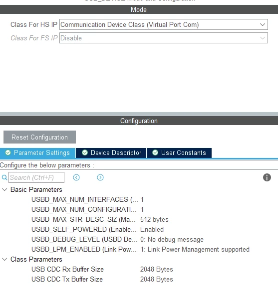

Hello, for the last couple of days I've been trying to set up my STM32F723ZET6 project as a USB HS CDC device with internal PHY.
My code gets stuck in this loop
 do
 count++;
 if (count > HAL_USB_TIMEOUT)
 return HAL_TIMEOUT;
 } while ((USBx->GRSTCTL & USB_OTG_GRSTCTL_CSRST) == USB_OTG_GRSTCTL_CSRST);
inside the function .staticHAL_StatusTypeDefUSB_CoreReset(USB_OTG_GlobalTypeDef *USBx) in the file stm32f7xx_ll_usb.c
I've been reading and it seems like a common issue. I've tried applying some solution that work for other people, although they were asking for other models of STM, Without success.

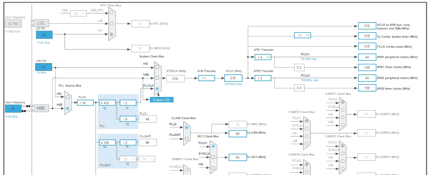

For what I read it seems to be some kind of timing or clock problem. I have no experience with USB and I don't really know much about how CUBEMX implementation works.
What I tried:
- Adding a 50ms delay before this loop
- Adding __HAL_RCC_SYSCFG_CLK_ENABLE(); to my HAL_MspInit function (Actually CUBEMX already did that)
-Adding __HAL_RCC_USB_OTG_HS_CLK_ENABLE(); to my HAL_MspInit function
- I also added both enables to the main.c file before MX_USB_DEVICE_Init(); just for trying
Some additional information:
I'll put some pictures here of various configuration and some info I think might be relevant:
Clock configuration:
Every other Mux not shown in the picture is greyed out
USB_OTG_HS config
USB_Device Config
Power management:
One of the things chatGPT suggested was about the VBUS detection. It says that it must be enabled (it may be talking about other STM32 model). I didn't find any PWR configuration in my pinout view, not under System Core neither in the categories list. I don't know if my version of STM manages that internally.
-VDD12OTGHS pin is bypassed with a 2.2uF ceramic capacitor
-OTG_HS_REXT pin is pulled down with a 3K 1% resistor
-Both VDDUSB and VDDSDMC are managed by an external TPS389033 power management IC to generate a small delay after powering VDD, as specified by the datasheet. (I also tried bypassing it). And both are bypassed with a 100nF and a 10uF ceramic capacitor.
Please ask if you need any extra information.

waclawek.jan
May 20, 2025 8:41 AM UTC
Read out and check content of all registers related to the PHY's supply and clock. Measure voltage on VDD12OTGHS pin. Make sure RCC_APB2ENR.OTGPHYCEN is enabled as well as RCC_AHB1ENR.OTGHSEN , and that USBPHYC_PLL1 is set properly. Also make sure HSE is working as intended, perhaps outputting it to MCO.
> chatGPT
Maybe you should prefer reading the datasheet and RM.
BRapo.1
BRapo.1Author
May 20, 2025 10:56 AM UTC
Thanks for your reply, I checked the registers and RCC_APB2ENR.OTGPHYCEN and RCC_AHB1ENR.OTGHSEN are both enabled.
I checked the value of USBPHYC_PLL1, it is enabled and set to 16Mhz (I don't really know what those 16Mhz mean)
I also checked USBPHYC_LDO and USBPHYC_LDO.LDO_DISABLE is set to 1, I don't know if the LDO should be enabled at the point of the core reset.
I measured the voltage at the VDD12OTGHS pin and it's 1.25V
I did a Master Clock output and got a frequency reading of 16Mhz
May 20, 2025 9:32 AM UTC
Hi @BRapo.1
Do you use reference board F723E-Disco? Or custom board? I suggest check compiler optimization, PHY frequency. Try to decrease CPU frequency.
To give better visibility on the answered topics, please click on "Best answer" on the reply which solved your issue or answered your question.Best regards,FBL
May 20, 2025 12:58 PM UTC
Hi @BRapo.1
The RCC OTGHSULPIEN is still required even for the internal HS PHY. We have ongoing internal tickets 204861 204937 to update code generation to align with the firmware.
