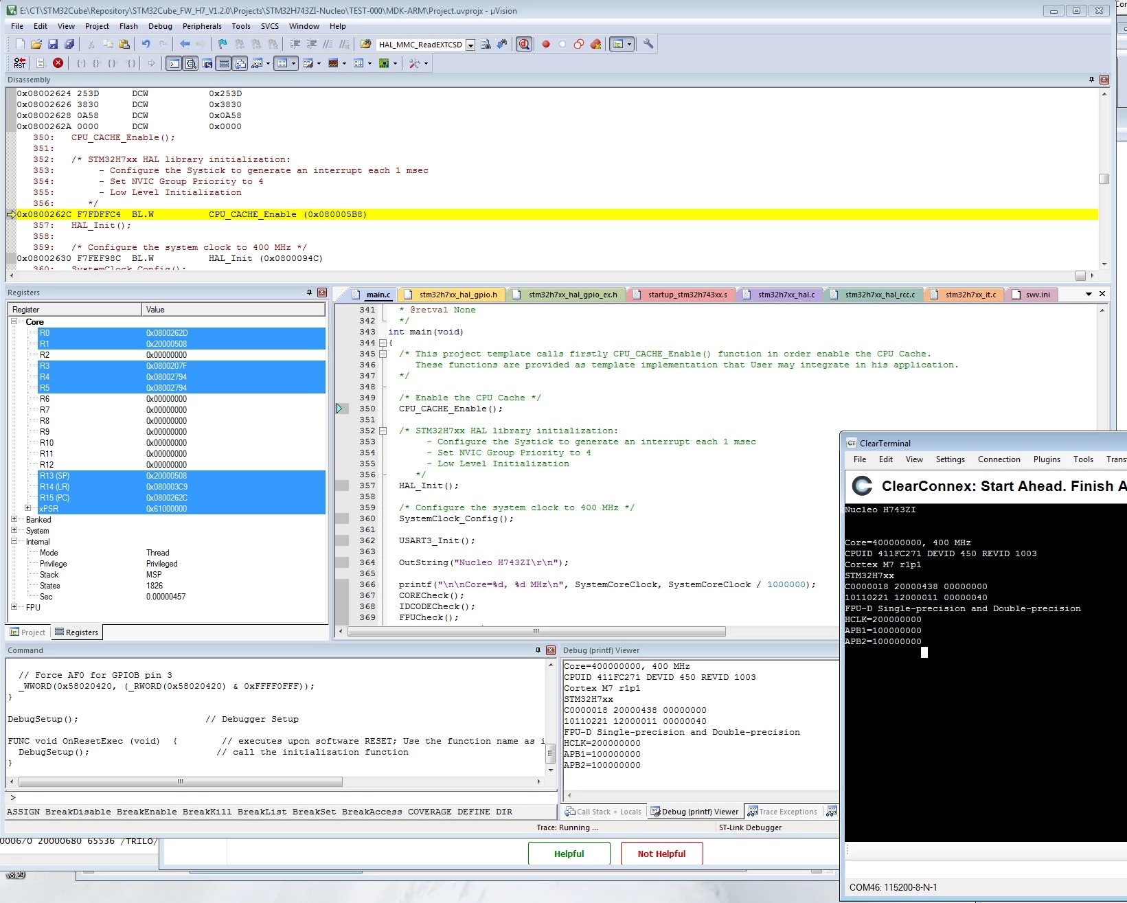

    The NUCLEO-H743ZI has a USART connected to the VCP provide by the ST-LINK, you can send data to the USART on the H7 side and get the data on a PC side terminal application.
    You can also connect a SiLabs CP2102 type USB-to-CMOS Serial dongle to any of the other available USART on the board.
    You can also use the Serial Wire Viewer (SWV SWO/PB3) as a debug terminal.

    I managed to see printf using the SWV.

    The User Manual and Schematic indicate it is USART3 on PD8/PD9
    ranran
    Senior
    December 13, 2018
    It does work with USART3, just what I needed ! Thanks a lot
