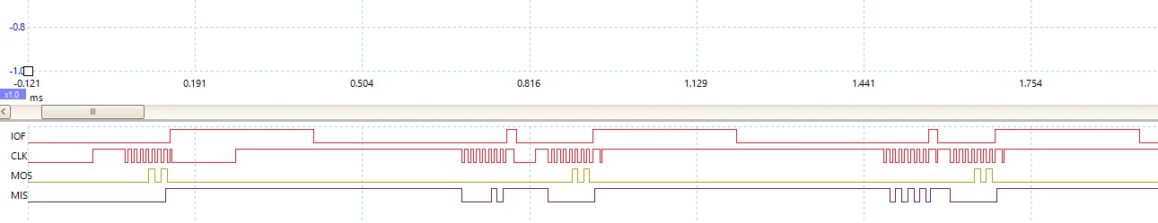

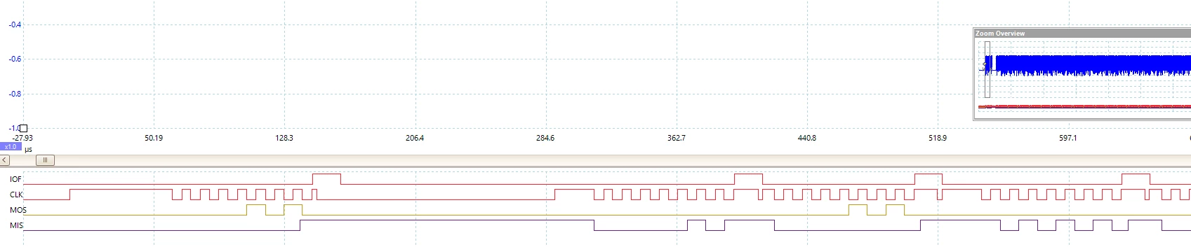

    TJ,
    I don't have question for SPI -- it works fine.
    My question is about the spi non-related delay loop:
    for(n=0; n<1500; n++); that it took too long but I don't know what had caused the problem.
    Brian

    Brian D
    Brian DAuthor
    April 21, 2018
    Posted on April 21, 2018 at 07:20
    This is just a simple test code to emulate a camera controlling the lens via a sort of SPI bus. The delay counting loop is a quick way for the test; without any interrupts the countering loop should be precise. No floating here; just unsigned int. I'd like to know where to look for the cause of this behavior.

    Brian D
    Brian DAuthor
    April 24, 2018
    Posted on April 24, 2018 at 03:34
    OK, I think here is the reason why the for() loop counter is so unpredictable. It seems the compiler might optimize or ignore a dummy loop as the for(n=0; n< 500; n++);
    So I changed it to
    for(n=0; n<100; n++)    Temp = SPI2.DR;      // read SPI2 data register (assuming 100X read would have the same delay as wished. This forced the tool not to ignore or did funny thing with the loop, and I got the consistence counting delay.
    So the lesson learned is do not use an empty for() loop for delay -- it is unreliable.
    Thank you all for trying to help.
