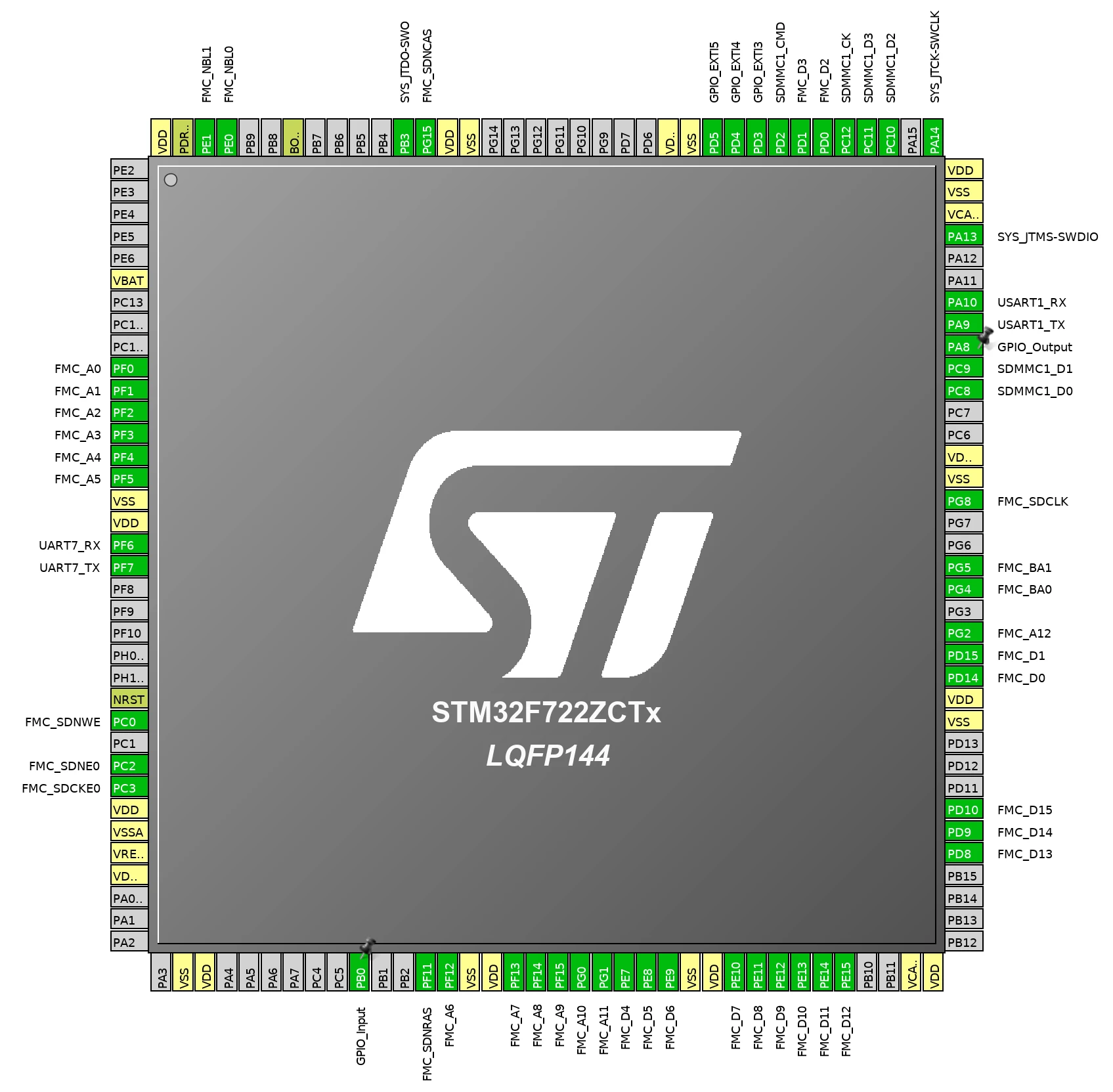

And here's my CubeMX config.  All signals are connected to the obvious counterparts, and the non-obvious ones are SDNE0 -- CS, NBLE1/0 -- DQMH/L.

(Note: My pin assignment code seems to be waiting for moderator approval.)

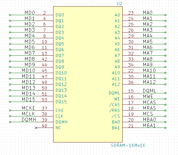

SDRAM schematic (9 column bits, 13 address bits):

Which Micron Part ♯ specifically are you using, I want to pull the data-sheet?
Can I use USART1 PA9/PA10 for debug/diagnostic output?

Yes, you can use USART1.  The Micron SDRAM is part ♯  MT48LC16M16A2-7E.
