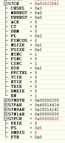

sintab_wa is located in RAM (0x2001414C). I use TIM2 on DMA1 for the request (stream 7 channel 3) but I update TIM10->CCR1 with the new value from sintab_wa. Yes, I like to hookup things as much as possible :)

Posted on July 08, 2016 at 09:11
Post the relevant DMA registers' content.
andre239955_st
July 8, 2016
Posted on July 08, 2016 at 10:27
Ok, here we go:
AR.
