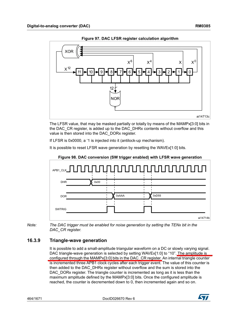

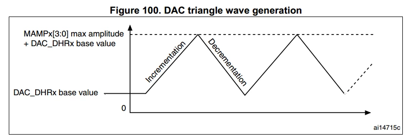

I am trying to control the amplitude of a triangle wave, while the frequency of the waveform should always be 1kHz. Is this possible to do?

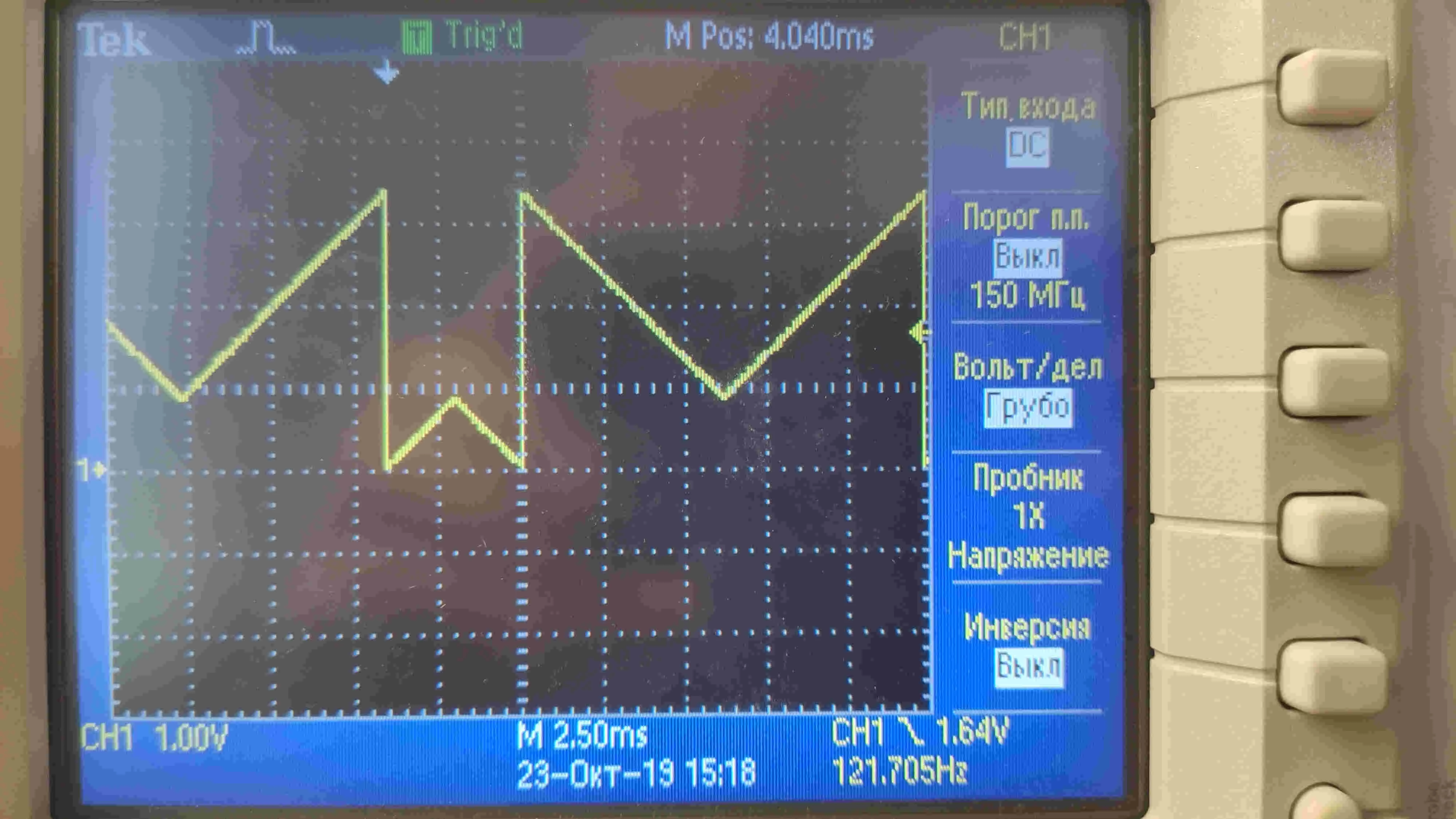

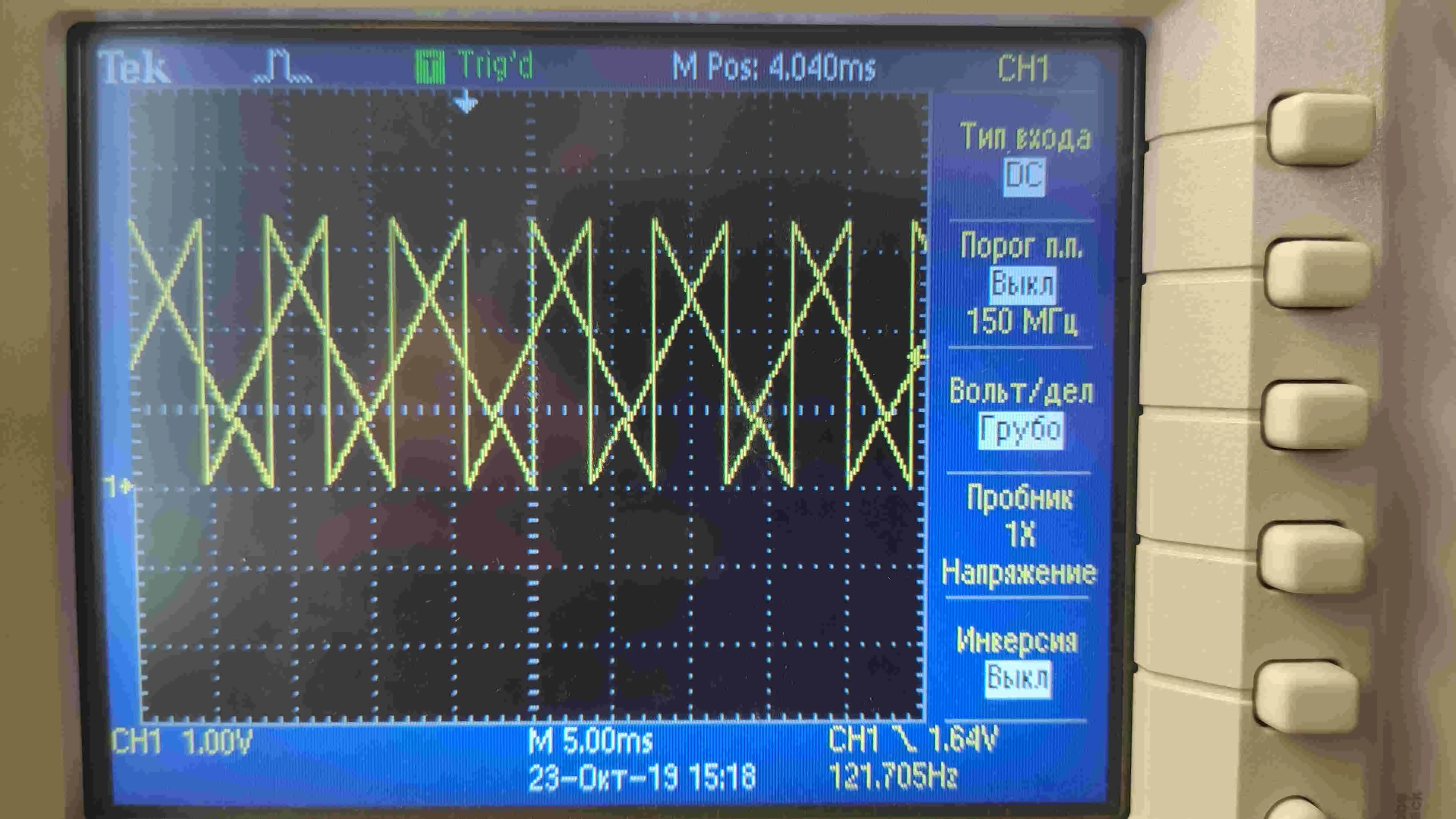

The reference manual says that I can control the amplitude of the signal using the register DAC-> DHRx. Further, to remove the DC, I use a ceramic capacitor, but when I write to register DAC-> DHRx a number any but 0 there, I get some kind of nonsense ...
I set the first channel for the event from TIM6 to the DAC, but I can not adjust the frequency of 1 kHz.

DAC -> CR |= DAC_CR_WAVE1_1; //1x: Triangle wave generation enabled
DAC -> CR |= DAC_CR_MAMP1_0 | DAC_CR_MAMP1_1 | DAC_CR_MAMP1_3; //≥ 1011: Unmask bits[11:0] of LFSR/ triangle amplitude equal to 4095
DAC->DHR12R1 = 1024;

TIM6->CR1 |= TIM_CR1_CEN;Is it even possible? Or if I change the value of the DAC-> DHRx register, will the frequency also change?
In general, what solution can there be to change the amplitude of a triange wave with a frequency of 1 kHz?
