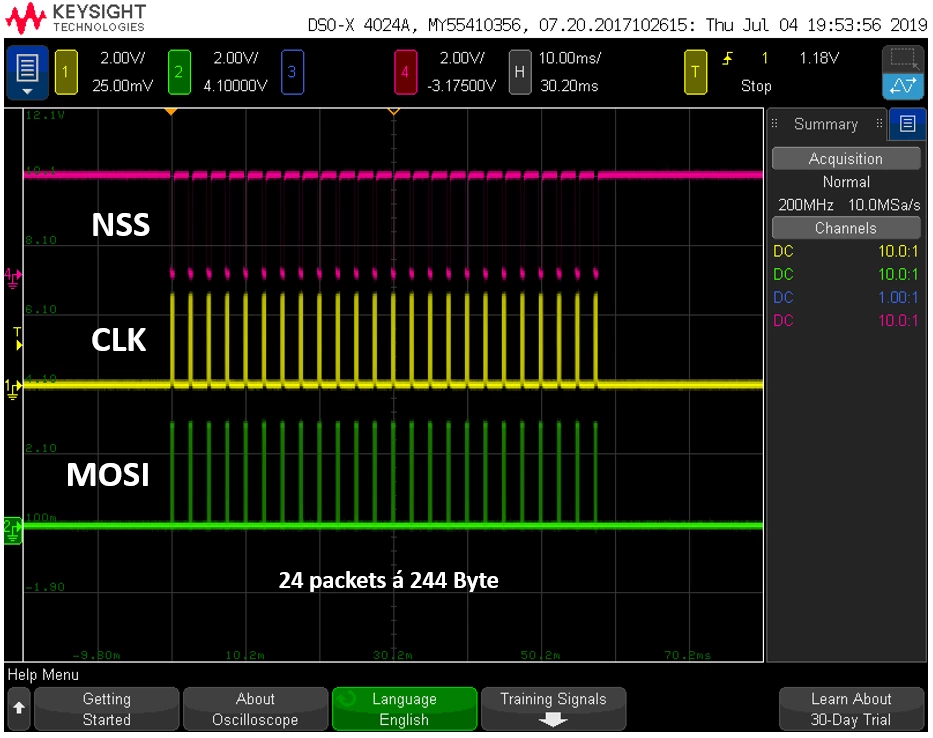

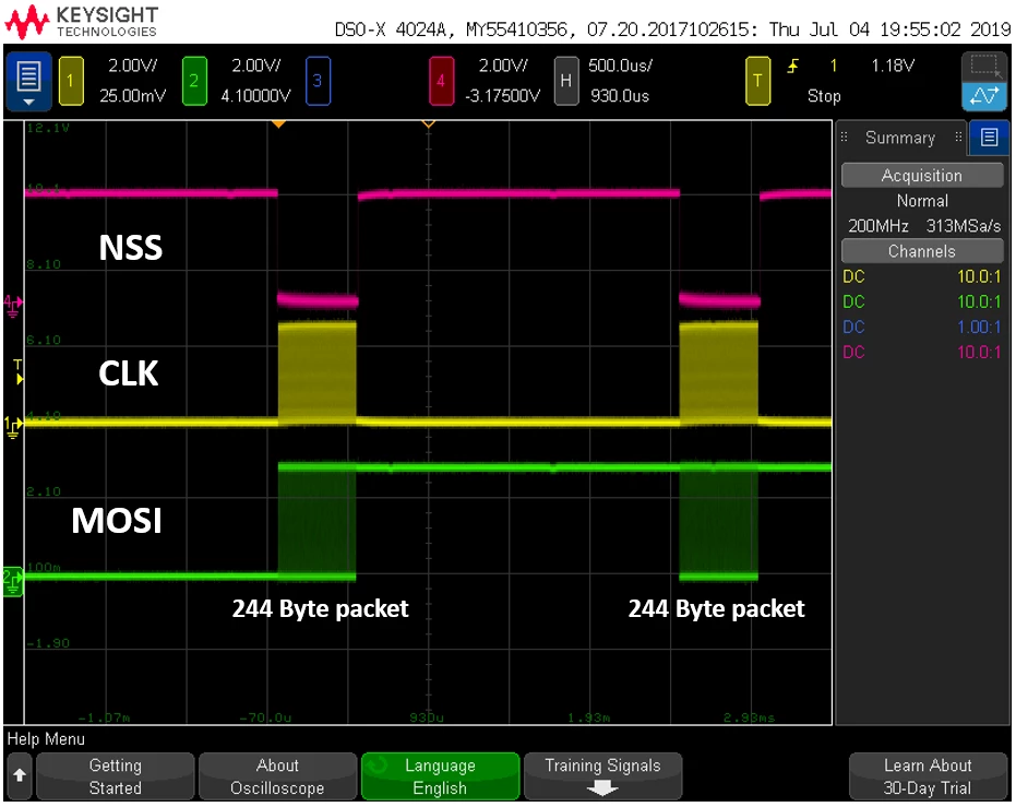

AWent
AWentAuthor
Jul 4, 2019 12:51 PM UTC
Due to the SPI transfer.
Attached are 2 oscilloscope captures of a 5800 byte (netto) (5856 byte brutto to fill up the 24th packet) frame transfer.
So all data will be transfered every time. I checked that several times.

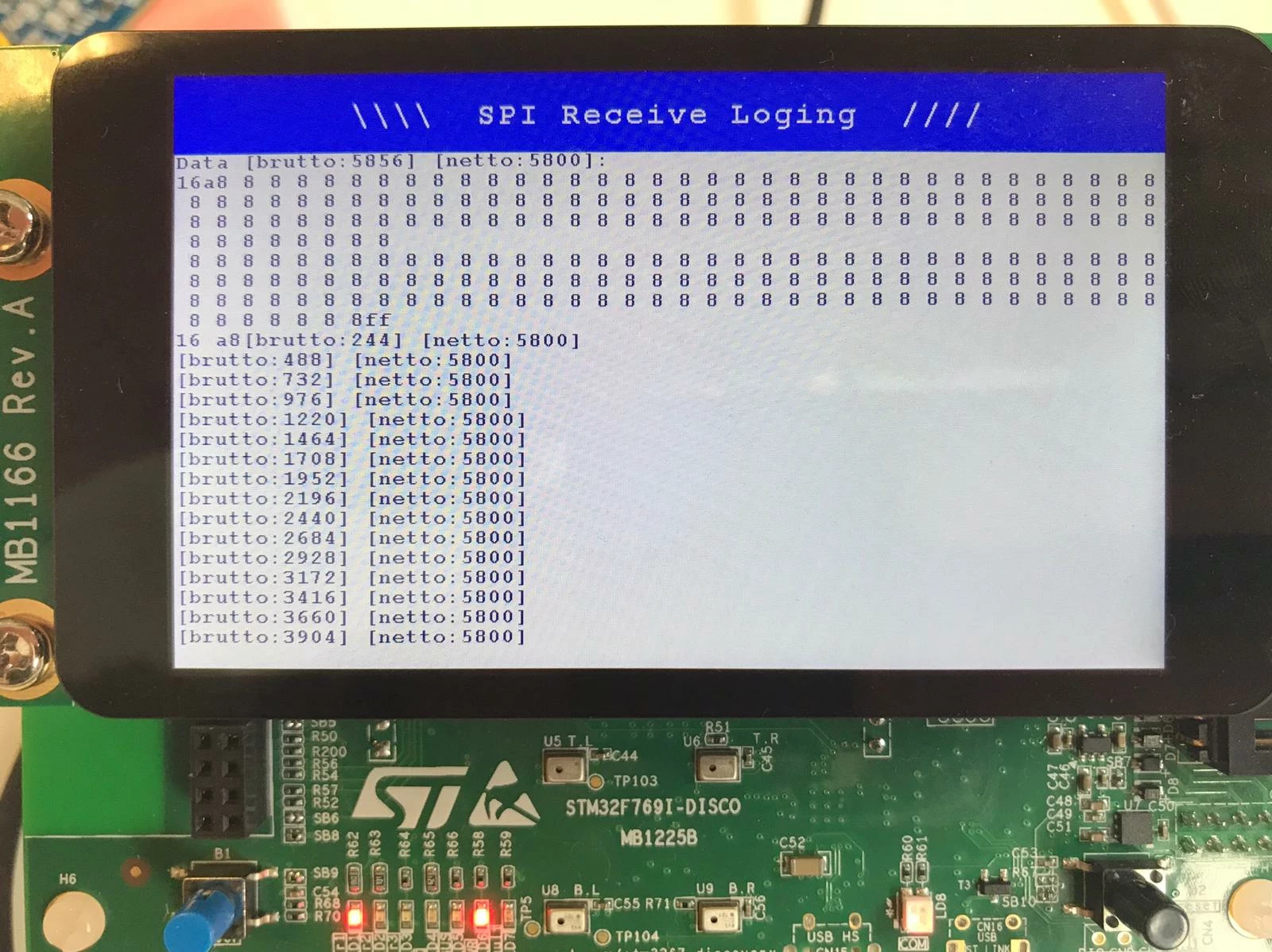

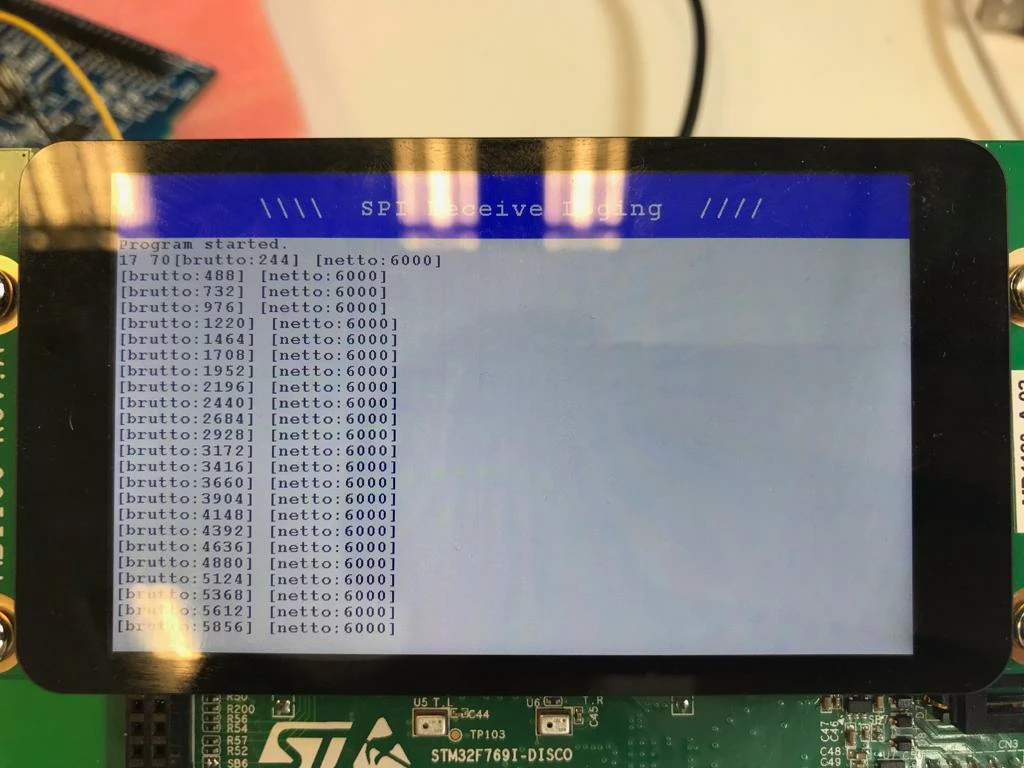

AWent
AWentAuthor
Jul 4, 2019 1:05 PM UTC
These are snippets of my SPI Receive log (print command).
I only print the first and the last 2% of the data, otherwise the printing would take too long.
Here I transfered 5800 byte netto (5856 byte brutto to fill up the 24th acket again).
First the transfer worked fine.
Then the MCU hang up while receiving the next data frame.
A 6 kByte data frame wouldn't even work at the first transaction. It hangs up immediately.0690X000009YQ5zQAG.jpg
By the way: The dummy data I transfer is just a counter counting up in every byte. Just the first byte is the net amount of data. And the last byte is a 0xFF to indicate the end of the dummy frame.

AWent
AWentAuthor
Jul 15, 2019 12:03 PM UTC
Now, from this code I understood how to implement the "pointer-shifting" for DMA ( buffer+i*512 ), thanks.
I updated my code now and got rid of the copying parts. Thus, my received data will be written in the frame_buffer immideately.
That works so far, but still does not solve the main problem that the devices hangs up.
@Frank Bauernoeppel: Is your setup still working if you increase the data amount? Up to e.g. 10, 12 or even 20 packets á 512 Byte?
The code you presented is sending 4096 Byte per transaction. At my setup that works for roughly 50 transaction till the systems hangy up.
As closer as I go towards the 6000 Bytes per transfer, the system hangs up earlier and earlier.
