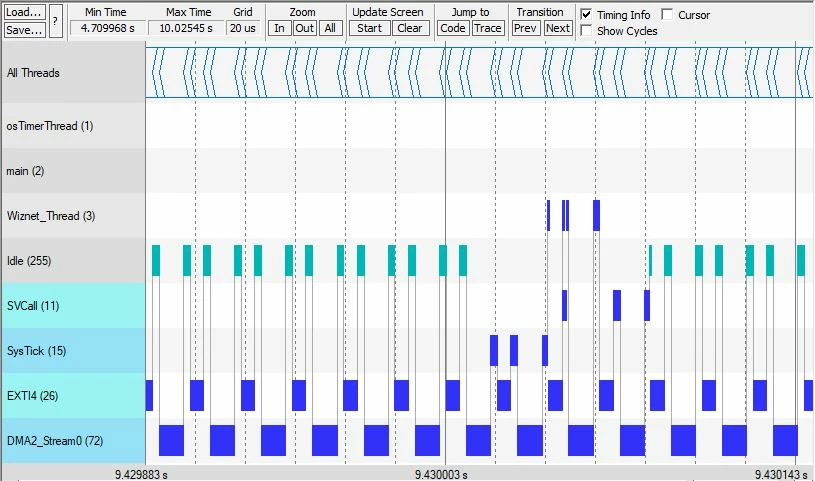

Hi All
I'm looking for solution. I have to communicate my external ADC with STM32F7 by SPI. I have request from ADC on DRDY pin with 50kHz, which I set as EXTI in the procesor. But how to control SPI DMA by this DRDY PIN? On each falling edge on DRDY, SPI should read 12Bytes.
I want to fill buffer with e.g. 500 data rates from ADC and then do something with it.
My code:

Why not just start the DMA transfer from the EXTI ISR?
mchomnicki9
October 20, 2017
Posted on October 20, 2017 at 16:41
Because transmitting in DMA_NORMAL mode on each EXTI ISR take to much resources. You can see on the time diagram.
Alan Chambers
October 20, 2017
Posted on October 20, 2017 at 16:58
Ah. I missed the 50kHz part. Not sure why the ISR should take ages, though.
