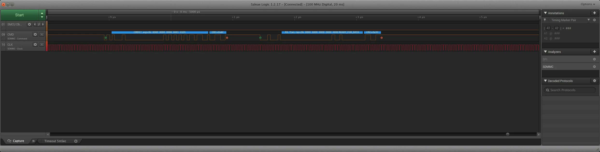

I'm seeing cases where the F7's SDMMC isn't setting any of the required Status Register bits as the result of
an R1 response to a READ_SINGLE_BLOCK command after having previously handled up to tens of thousands of
identical sequences. The SDMMC_GetCmdResp1() function in stm32f7xx_ll_sdmmc.c waits (with a sad excuse for a
timeout loop) for (SDMMC_FLAG_CCRCFAIL | SDMMC_FLAG_CMDREND | SDMMC_FLAG_CTIMEOUT) to appear in SDMMC_STA.
Aside from a belt & suspenders & duct tape & sandwich board problem-detection approach the SDMMC_GetCmdResp1()
timeout loop should never time out given that, at the very least, SDMMC_FLAG_CTIMEOUT must be asserted after 64
MMC clocks (according to RM0410 Section 39.3.1 and 39.8.11 Bit 2 CTIMEOUT description). And yet the sad
timeout loop does indeed pop.
Attached is a screenshot of a logic analyzer trace showing a CMD17/READ_SINGLE_BLOCK command to an eMMC device
along with its R1 response. The logic analyzer's trigger was SDMMC_GetCmdResp1()'s timeout. There's no MMC
command/response traffic between the R1 response and the trigger, so all interaction with the eMMC stopped
because the impossible happened: there's obviously a response from the eMMC but no indication of any sort made
its way to the SDMMC Status Register. If I understand things correctly, one of the three indications in the
SDMMC Status Register (SDMMC_STA) (CCRCFAIL, CTIMEOUT, and CMDREND) *must* be asserted within 65+48 MMC clocks
after the command is sent.
After SDMMC_GetCmdResp1()'s timeout the SDMMC_RESPCMD contains 0x11, indicating that the SDMMC did indeed
receive the response to the CMD17. The SDMMC seems to have just forgotten to set a Status Register bit.
Examined with an oscilloscope, both the eMMC's CMD and CLK signals look good from a signal integrity
standpoint. No power or noise problems have been noted on any boards. Further, this problem has been observed
on multiple boards, with eMMC's from multiple manufacturers, at different MMC clock rates, and at wildly
variable times while the tests are running.

    I spent some quality time with merge comparing F7's FW 1.11.0, 1.12.0, and the SD versus MMC forks. They're all the same with respect to the described problem, which is encouraging as I don't see that the code is doing anything wrong. The problem is bits that must be set by the SDMMC after receiving an R1 response aren't. The code is just sitting and polling for the bits until SDMMC_CMDTIMEOUT is reached, which cannot happen according to the Reference Manual and all the MMC spec information I can find.
    Additional instrumentation in the code and more testing today showed that this behavior isn't isolated to READ_SINGLE_BLOCK. The block writes as well as SEND_STATUS and SET_BLOCKLEN all have been seen to have their R1 responses ignored by the SDMMC.

    Do you happen to be using an RTOS and the SDIO in DMA mode? I've just solved what I believe is the same problem in the STM32F4 HAL drivers.
    The problem presents itself when an RTOS context switch happens AFTER SDIO_SendCommand() is called (which begins to clock out the CMD), but before the SDMMC_FLAG_CMDREND flag is set. If a task context switch happens at this time, and does not return to the current task before SD_DMAReceiveCplt() is called, the SDMMC_FLAG_CMDREND is cleared, and never "noticed" by the SDMMC_GetCmdResp1() timeout loop.
    In the attached Saleae Logic capture:
    ERROR is low after an SDIO timeout occurs.
    SDIO wait_loop is low when entering the waiting loop in SDMMC_GetCmdResp1(), high when exiting
    ClearSDIOFlags is low then high whenever the SDIO flags are cleared.
    SD_CMD is the SDIO CMD line
    SD_D0 is the SD_D0 line
    PJ11 goes low then high each time the loop in SDMMC_GetCmdResp1() checks the flags in the loop.
    When the error happens at the end of the capture, an RTOS context switch happens so the CPU executes another task shortly after SDIO_SendCommand() is called. The flags are not being checked at this point, and while they are properly set, they are eventually cleared by the SD_DMAReceiveCplt() ISR function before SDMMC_GetCmdResp1() ever gets back into the execution context.
    Hope this helps.

    Guys, sorry for the delay and the poor effort at a proper response, I'm traveling, but I think you'll get the idea.
    My "workaround" was to add a flag in stm32f4xx_ll_sdmmc.c and check for that flag in the do/while loop of SDMMC_GetCmdResp1 function.
    //FLAG AND SETTER
    static uint32_t cmdRespStatus = 0;
    void SDMMC_SetCmdResponseStatus() {
       cmdRespStatus = 1U;
    //MODIFIED GETCMDRESP1
    static uint32_t SDMMC_GetCmdResp1(SDIO_TypeDef *SDIOx, uint8_t SD_CMD, uint32_t Timeout)
     uint32_t response_r1;
     /* 8 is the number of required instructions cycles for the below loop statement.
     The Timeout is expressed in ms */
     register uint32_t count = Timeout * (SystemCoreClock / 8U /1000U);
     do
        if (count-- == 0U)
           return SDMMC_ERROR_TIMEOUT;
     }while((!__SDIO_GET_FLAG(SDIOx, SDIO_FLAG_CCRCFAIL | SDIO_FLAG_CMDREND | SDIO_FLAG_CTIMEOUT)) && (!cmdRespStatus)); //<<Workaround
    Then set the flag in the SD_DMAReceiveCplt ISR callback function in stm32f4xx_hal_sd.c :
     /* Clear all the static flags */
     SDMMC_SetCmdResponseStatus(); //<<workaround
     __HAL_SD_CLEAR_FLAG(hsd, SDIO_STATIC_FLAGS);
    This way whenever the RTOS switches it's context back to the do/while loop in SDMMC_GetCmdResp1 it will catch that the flag is set and exit properly.
