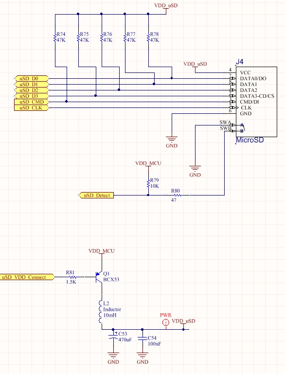

Hi there
I waste much time on mounting sdcard in my prgram. the chip is stm32f745vg and i work with Firmware version 1.7 CubMX 4.19 and Keil 5.16
in CubeMX, i choose SDMMC1 in 1-bit mode with clock 48MHz(PLLQ=9) and FatFS --> SD Card. i leave Fatfs Options in Default(no change). other Configurations:
Flash Interface --> Enable
ART ACCLERATOR --> Enable
Instruction PreFetch -->Enable
CPU ICach --> Enable
CPU DCach --> Enable
GPIO Configuration
SDMMC divide Factor=0
when i try to use f_mount function, i receive FR_DISK_ERR error as result Value.
no difference in Activating SD interrupt. my program is :

my SD Configuration is :
static void MX_SDMMC1_SD_Init(void)
{hsd1.Instance = SDMMC1;
hsd1.Init.ClockEdge = SDMMC_CLOCK_EDGE_RISING; hsd1.Init.ClockBypass = SDMMC_CLOCK_BYPASS_DISABLE; hsd1.Init.ClockPowerSave = SDMMC_CLOCK_POWER_SAVE_DISABLE; hsd1.Init.BusWide = SDMMC_BUS_WIDE_1B; hsd1.Init.HardwareFlowControl = SDMMC_HARDWARE_FLOW_CONTROL_DISABLE; hsd1.Init.ClockDiv = 0;}
Please Help me!!!!
