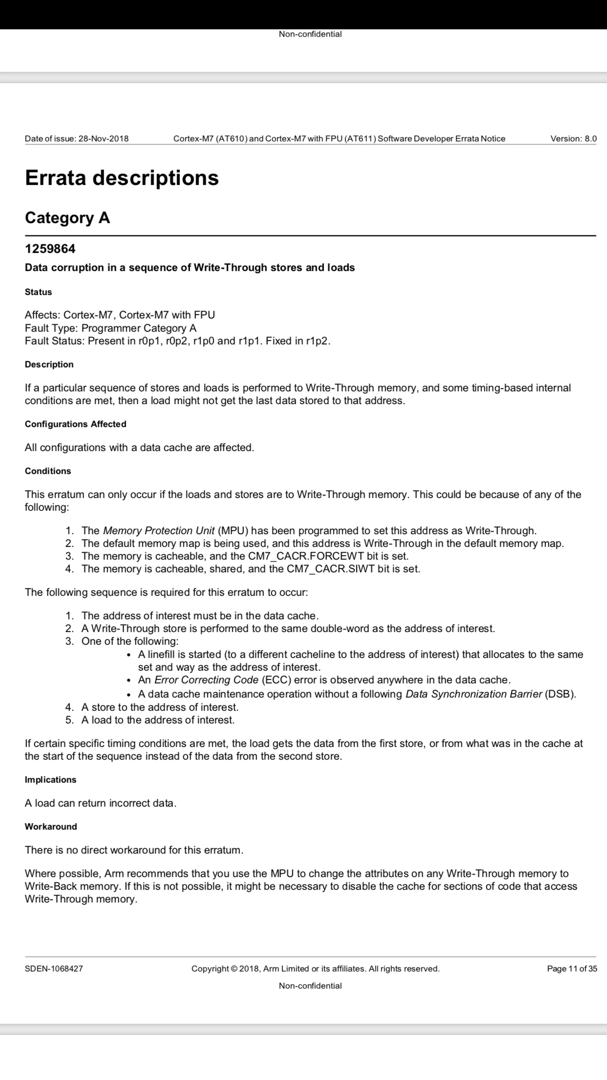

    STOne-32
    Jan 17, 2019 5:59 PM UTC
    Dears,
    Thank you for spotting this complex case, we will discuss internally the case if you can send me in private the OLS Ticketnumber for close follow-up with your local contact.
    In mean-time, recently by end of december, our Core/Partner - ARM published a new errata at Cortex-M7 cache that may is the root cause ( to be confirmed after case reproduction from our side)
    Category A - 1259864
    Data corruption in a sequence of Write-Through stores and loads
    Workaround
    There is no direct workaround for this erratum.
    Where possible, Arm recommends that you use the MPU to change the attributes on any Write-Through memory to Write-Back memory. If this is not possible, it might be necessary to disable the cache for sections of code that access Write-Through memory.
    We are updating soon our STM32 Errata as well having Cortex-M7 : F7/H7 series. Direct link at our partner web page is here, then login/register - https://silver.arm.com/download/download.tm?pv=4462869&p=1929427

    Christensen.Tyler
    Jan 30, 2019 2:24 PM UTC
    After my 6th ignored "can someone please respond to this ticket?" over the last 2.5 months, yesterday someone finally responded saying they thought the issue was resolved. They are now aware the issue has not been resolved. We'll see if that avenue of help goes anywhere.

    andy
    andyAuthor
    Jan 30, 2019 7:51 PM UTC
    Thank you, but I'm not sure I see how this specific erratum results in spurious activity on the QSPI bus.
    I interpret the symptom as "CPU may read data which is out-of-date", which clearly is bad news and well worth knowing, but it doesn't explain reads occurring to locations or devices which the code isn't accessing.

    CHead
    Jan 30, 2019 9:08 PM UTC
    The ARM erratum only talks about write-through areas, and it only says that the data read back after a write may be incorrect. So I wouldn’t say the cache is useless; it’s still useful for RAM areas (which are write-back instead of write-through) and read-only areas. It also sounds like it’s not related to the QUADSPI issue.
    As for the QUADSPI issue, the CPU core is allowed to make speculative reads to any accessible, normal memory area whenever it wants (and 0x90000000, the QUADSPI memory mapped area, is of normal type in the default memory map). One might expect that, when the QUADSPI peripheral is not configured in memory mapped mode, such accesses ought to be ignored, but it seems that’s not the case. I just tried setting the address register to a nonzero value, reading from 0x90000000, and then reading back the address register, with the QUADSPI peripheral not even enabled (never mind set to memory-mapped mode). As expected the read from 0x90000000 faulted, but the address register was zeroed as a side effect! If such a read were generated speculatively, this would perfectly explain the observed behaviour. I’d suggest trying using the MPU to make the 0x90000000 region no-access when not using memory-mapped mode; according to the Cortex-M7 technical reference manual, speculative reads should not be generated to no-access memory regions. I’d be interested to hear if this helps solve anyone else’s issue.
