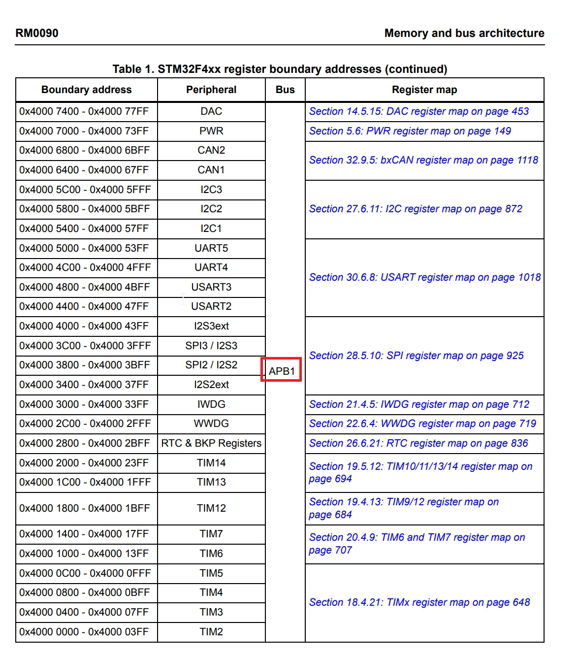

STM32F7, H7: Where can I find info from which APB bus is a given timer clocked?
Hello!
For some time already I cannot find this in manuals. Can someone point me if there is any table somewhere? Of course I can find it out experimentally, but it would be more convenient to know where it is listed.

The mapping is contained in the table Register boundary addresses, usually in section 2 of the Reference Manual. In addition to the border addresses, it also contains the responsible bus.

Thank you very much! For sure I wouldn't find this place myself :)).

I opened the RM but looked over it, for those not awake in the morning this visual :):
May 18, 2024
In RM0433 which I am using for the STM32H753, the timer clocking can be determined by the RCC_APB1LRSTR and RCC_APB2RSTR register definitions in Section 8.8, Table 84.
