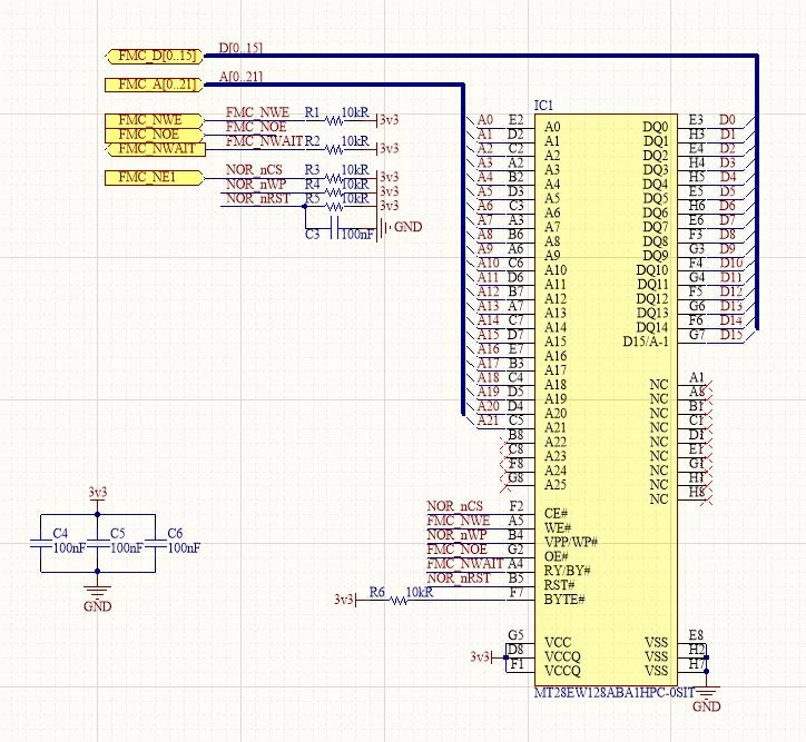

Hello everyone,
I have designed a board with STM32F750N8, 22 Bit Parallel Nor Flash, 13 Bit SDRAM, QSPI Nor Flash.

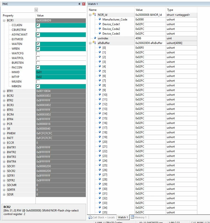

Now i am trying to read, write data, read device id from fmc nor flash (other memories not enabled). But when i try to read device id, getting 0x90 as Manufacturer Code, 0x2FC as Dev Code 1, 2, 3.
When i read back what i wrote, i am getting 0xF0 as first word (16bit), 0x2FC as rest of the 4096 word (16bit).
I think nor flash works but somehow there is a problem and cause this. What am i missing? I coppied STM32756G_EVAL FMC Nor example. Even timings.
I have attached my nor flash schematic, cubemx project, some codes.
I used MT28EW128ABA1HPC-0SIT flash memory IC.
What am i missing? Why 0x02FC is everywhere?
NOT: I am using internal RC oscillator with 216 MHz.
