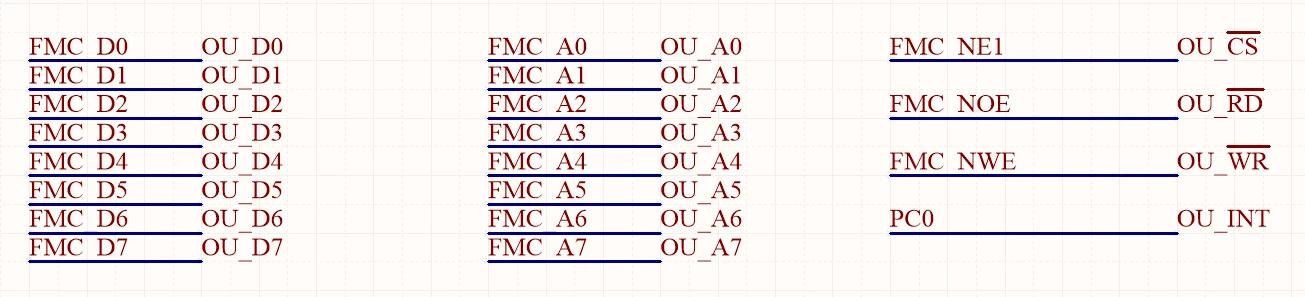

I`m going to use an octal uart IC named XR16V798 and my MCU is a stm32f756z,
I printed my own designed board which connected these two ICs as follows:
0693W00000UnuCVQAZ.pngjust to mention, I haven`t used FMC with any other device before, now I dont know how to work with this IC,

Read the FMC chapter in RM.
Your chip's registers are now mapped to STM32's memory, as you use FMC_NE1 ie. Bank 1 - NOR/PSRAM 1, at address 0x6000'0000. It means, you can access the registers e.g. in this way:
#define XR16V798_REG0 *(volatile uint8_t*)0x60000000
#define XR16V798_REG1 *(volatile uint8_t*)0x60000001
XR16V798_REG0 = new_value_for_register_0;
readout_value_from_register_1 = XR16V798_REG1;
However, to get this working properly in 'F7, you need to set the region starting at 0x6000'0000 as Device in MPU. Alternatively, remap it to 0xC000'0000 using SYSCFG_MEMRMP.SWP_FMC, then the above macros would of course also using the 0xC0000000 address.

That was a really hard job. I added some piece of code as you mentioned:
in header file
#define MPU_TYPE     (*((volatile unsigned long*) 0xE000ED90))
#define MPU_CTRL     (*((volatile unsigned long*) 0xE000ED94))
#define MPU_RNR     (*((volatile unsigned long*) 0xE000ED98))
#define MPU_RBAR     (*((volatile unsigned long*) 0xE000ED9C))
#define MPU_RASR     (*((volatile unsigned long*) 0xE000EDA0))
in C file
void Config_MPU(void)
 MPU_RNR = 0x00000003;
 MPU_RBAR = 0x60000000;
 MPU_RASR = 0x0301FF0F;
 MPU_CTRL = 0x00000005;
and after those in my main file, I have:
 SYSCFG->MEMRMP &= 0xfffff3ff;
 SYSCFG->MEMRMP |= 1<<10;
not any success. I cant see any square waves in my oscope.
