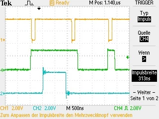

I am working on a custom board with the STM32F746IGT6. in witch is a FTDI Parallel-USB converter is connected to the FMC. My problem is that when I try to read data to ''fast'' from the FMC(after a while, and only sometimes) the FMC reads twice for one cycle. And the read function returns the result from the last transfer. This error is only sometimes and I didn't find any relationship with the content of the data. If I slow the velocity in them I pull data (> 2ms) then I have no more errors. The following image showsthe
sporadically
two reads at the same call. The yellow line is the read trigger. The blue line is the write trigger. Andthe green lineis an output pin that I trigger with software to recognizewhentheread function is called. 0690X000006035SQAQ.jpg here is the code when I call a read:

> Is anything else connected to the FMC
Yes, I have some shift registers to expand my IOs. But in other addresses.
I have already comment away all other calls from the FMC to be sure that there is no collision, without success.
I haven't looked yet if by reading the IOs it also does a double read sometimes. (I will try it later)
In this case, a double read will not affect the inputs. The problem by the FTDI is that by each read pulls a character from the fifo. So that if the FMC makes a double read the first character get lost.
> do you use any other bank?
No.
> Is this the only place where you read from that address range?
Yes. Thats why I toggled the pin with the green signal. to verify that no other place calls this function.
> Do you always read from the same address?
For the FTDI yes (0x68000000 + 8). I use other addresses for my IO expander.
But as previously mentioned I turned all other calls off.
> Is the write into the same address/address range?
Yes same as the read (0x68000000 + 8).
I think the FMC is trying to make a refresh. or the Hardware detects (don't know how) an error by the first
read and try it again.
Is there a configuration for such behave? thanks
Robert

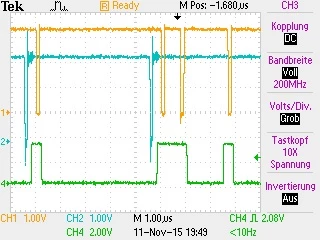

Thank you for your post. It helped me to locate the problem. In fact the problem is an interrupt intermediately or perhaps between the FMC access. It creates a second read from the same address after the interrupt is ended. To test this I used the following code running in the main function:
1.
SETPIN(H, 14); //green signal high
2.
tmp = (*(__IO uint8_t*) (NOR_MEMORY_ADRESS3)); //yellow signal.
3.
RESETPIN(H, 14); //green signal high
Then at the beginning of my interrupts I turned a second signal (Blue) on and at the end off. I tested this with the USART_IRQ and the Systick_IRQ, with same result. The following oscilloscope image shows the behavior: 0690X000006035XQAQ.jpg The yellow signal represents the read function of the FMC at the pin NOE The green signal represents the time used by the FMC access The blue signal represents the time used by the interrupt. The assembler code of my test function is:

So no indication what could run wrong besides an interrupt handle problem while reading in the FMC. I suspect that this behavior is the same while writing. But I have not tested it yet. My solution for now is to turn the interrupts off before the access and to turn them on again after that.
1.
__disable_irq();
2.
3.
__enable_irq();
greetings from Berlin Robert

But this is a nice gotcha. And I think I know the explanation (in fact, I asked the questions above because I read the following yesterday in the night): in the Cortex-M7 TRM, chapter 2.7.1 Exception handling:
To minimize interrupt latency, the processor can abandon the majority of multicycle instructions
that are executing when the interrupt is recognized. The only exception is a device or
strongly-ordered load, or a shared store exclusive operation that starts on the AXI interface. All
normal memory transactions are abandoned when an interrupt is recognized.
The processor restarts any abandoned operation on return from the interrupt.
In M4, only division is abandoned/restarted. LDM/STM are interruptible/continuable (although this behaviour can be optionally switched off) in both.
Thus, the M7 trades speed for this ''non-external-device-friendly'' behaviour. Note, that the 60000000-7FFFFFFF area is marked as RAM, non-Device, in the ARMv7 architecture manual (Table B3-1). I see no other workaround except disabling interrupts during the accesses, just as you did.
Your relatively high setup etc. settings exacerbated the problem. Luckily, otherwise you might have had the dreaded ''fails once in blue moon'' case. When you have set longer periods for the reads, I guess the problem persisted just its occurence lowered so you did not experience it.
Writes can be cached, which can hide this problem - or make it even worse, badly detectable, happening only upon cache exhaustion... I see you have switched off the write caching - can you please try this with both settings and report back, thanks.
