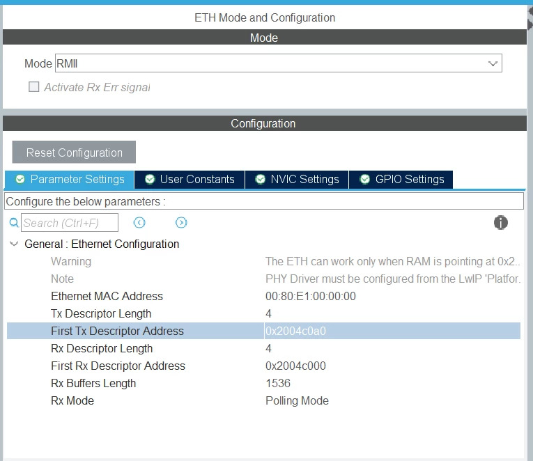

We have custom board based on STM32F745VGT6 having Ethernet peripheral over RMII mode.
Previously with the older version of Cube MX and Library our Ethernet was working, after the new update of library there are some major changes in the library and now it is not working i.e. we are unable to ping the board.

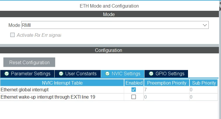

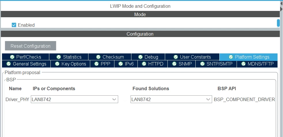

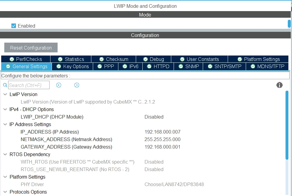

Below is the configurations used in my project.
NOTE: I am using Ehternet SWITCH and not PHY.
Configuration of the project:

Ethernet Configuration - 1Ethernet Configuration - 1
Ethernet Configuration - 2Ethernet Configuration - 2
LWIP Configuration - 1LWIP Configuration - 1
LWIP Configuration - 2LWIP Configuration - 2
 /*Memory configuration in STM32F745VGTX_FLASH.ld*/
MEMORY
RAM (xrw) : ORIGIN = 0x20000000, LENGTH = 320K
FLASH (rx) : ORIGIN = 0x8000000, LENGTH = 1024K
Memory_B1(xrw) : ORIGIN = 0x2004C000, LENGTH = 0xA0
Memory_B2(xrw) : ORIGIN = 0x2004C0A0, LENGTH = 0xA0
.RxDecripSection (NOLOAD) : { *(.RxDescripSection) } >Memory_B1
.TxDescripSection (NOLOAD) : { *(.TxDescripSection) } >Memory_B2
