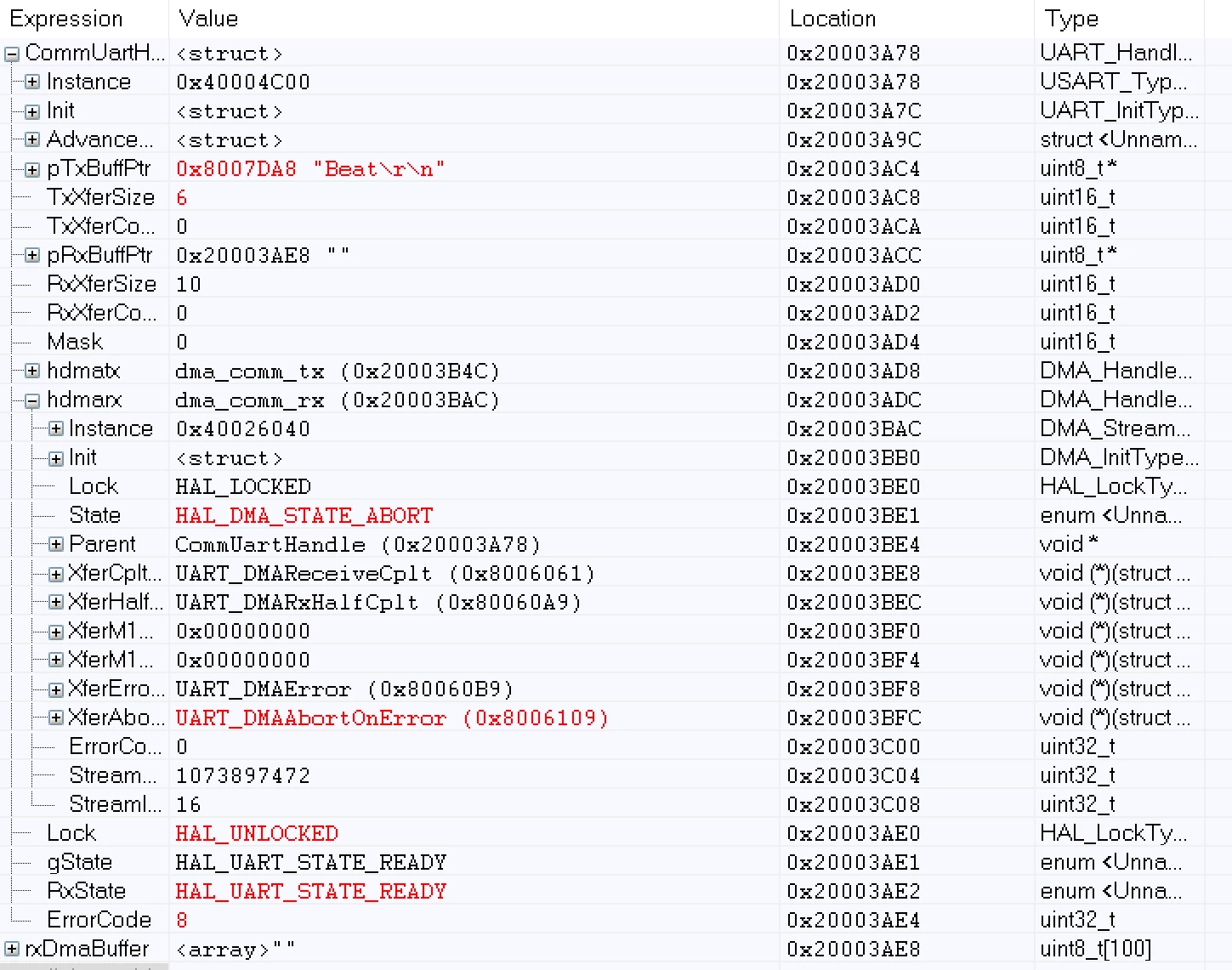

STM32F7 DMA UART RX no Data seen.
I am working with the STM32F7. I am implementing a DMA communications handler, preferably using the HAL (but LL is also an option that I have tried). I have successfully implemented the TX side of the equation but, am unable to get the RX portion to put data into the buffer. Below I have detailed the HW configuration and provided the HAL based code to match. I can also provide the LL based code should anyone want to see that. Can someone help me to see the error of my ways?
I am hoping to use the idle line detection to allow variable packet size, but cannot get the RX to work even with a fixed packet size.
I have used the following references:
Example code for Idle Line with f4: https://github.com/MaJerle/STM32_USART_DMA_RX
DMA Controller Guide: https://www.st.com/content/ccc/resource/technical/document/application_note/27/46/7c/ea/2d/91/40/a9/DM00046011.pdf/files/DM00046011.pdf/jcr:content/translations/en.DM00046011.pdf
Ref Manual: https://www.st.com/content/ccc/resource/technical/document/reference_manual/group0/96/8b/0d/ec/16/22/43/71/DM00224583/files/DM00224583.pdf/jcr:content/translations/en.DM00224583.pdf
LL/HAL Guide: https://www.st.com/content/ccc/resource/technical/document/user_manual/45/27/9c/32/76/57/48/b9/DM00189702.pdf/files/DM00189702.pdf/jcr:content/translations/en.DM00189702.pdf
Platform: NUCLEO-F767ZI
RTOS: uC/OS-III
UART: UART4 (RX: PC11, TX: PC10)

waclawek.jan
Jul 29, 2019 9:03 PM UTC
Polled implementation works?
Read out and check content of UART and DMA registers (carefully, readig UART status register clears its bits). Is Rx DMA enabled in UART? Does NDTR in DMA change? Is there no error signaled in DMA's status register?

EBepp
EBeppAuthor
Jul 30, 2019 2:51 PM UTC
0690X000009Zd3MQAS.pngJW the Registers are below in text and screenshot from IAR as well as attached in a log file. These values are captured when the DMA1_Stream2_IRQHandler fires after a transmission of 5 bytes. Please note the UART shows Error 8 (0verrun) in this scenario, not sure why that is.

waclawek.jan
Jul 30, 2019 3:22 PM UTC
I mean the hardware registers of UART and DMA, not HAL/Cube's intestinal content.
waclawek.jan
Jul 30, 2019 3:30 PM UTC
DMA1_Stream2 (Channel 4) is UART4_RX, so it's certainly not the consequence of *transmitting* bytes.
STM32Cube_FW_F7_V1.7.0\Drivers\STM32F7xx_HAL_Driver\Inc\stm32f7xx_hal_usart.h:
#define HAL_USART_ERROR_ORE         ((uint32_t)0x00000008U)  /*!< Overrun error      */
Overrun may be consequence of bytes arriving at UART while not being picked by a stuck DMA.
Observing the relevant DMA registers (i.e. the givern stream's registers plus the status registers) should shed more light on the problem.
In case it wasn't obvious, I don't use Cube/HAL and I also don't use 'F7 so if this is related to some memory mapping issue I am out.

waclawek.jan
waclawek.janBest answer
Jul 30, 2019 9:38 PM UTC
Well, it appears that you've captured the registers after Cube succeeded to clean up (it even cleared the peripheral- and memory-address registers and also NDTR of the DMA stream, which is weird, but then not everything in Cube makes sense), so there's no evidence of any significant error there. The only flag set in DMA_LISR is TCIF2 (ie. transfer complete interrupt for Stream 2), which is explained by the fact that it is set when software disables the channel forcibly (by clearing DMA_SxCR.EN) and Cube probably has disabled the DMA stream interrupt by that time.
Try to set a breakpoint in whatever error handlers Cube uses in both the UART and DMA ISR, and observe the registers there.
EBepp
EBeppAuthor
Jul 30, 2019 10:34 PM UTC
Thank you very much for your help - This helped me to find the issue. Turns out the HAL had not cleaned up the registers yet, but rather had never set them. The __HAL_DMA_ENABLE() had set the S2SCR->EN bit high, preventing the call to HAL_UART_Receive_DMA() (and then HAL_DMA_Start_IT()>DMA_SetConfig() )from changing the peripheral and memory address registers - Good lesson in making sure I know how ALL the registers relate to teach other. If you ever find yourself in Colorado, beers on me!
