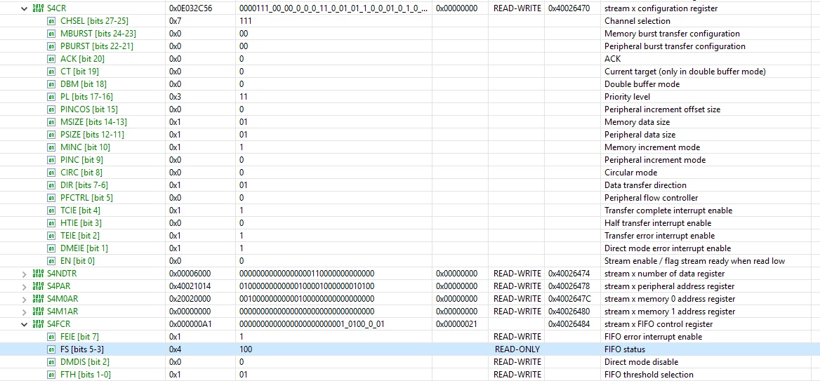

    Precisely, that's what I get : I enable the DMA (timer request disabled), then I pause debug and I see that the fifo level is between 0 and 1/4 (not marked as empty). I enable the timer request, then the full data is sent (NDT=0), and at the end I get a FIFO error (fifo level is marked as empty) ; the DMA is also automatically disabled (EN=0).
    And after that, I re-enable the DMA (with timer request disabled during init), and I get immediately a fifo error interrupt (timer request still disabled). When executing the interrupt, the register shows that the fifo level is empty and obviously no data has been sent.
    If i set the fifo burst equal to single, I don't have any FIFO error and the stream can be repeated as many times I need without generating errors...

    Post the content of the given DMA stream's registers.
    Aurelien Robert
    June 22, 2017
    Posted on June 22, 2017 at 14:07
    waclawek.jan
    June 22, 2017
    Posted on June 22, 2017 at 14:16
    I mean the situation when you have burst set .
    Aurelien Robert
    June 22, 2017
    Posted on June 22, 2017 at 14:44
    My mistake, I found the bug...(because when I looked another time to the screenshot I posted, the DMDIS was cleared...)
    I used the value 'DMA_PDATAALIGN_HALFWORD' for the MemDataAlignment parameter, instead of using 'DMA_MDATAALIGN_HALFWORD'. The HAL init was returning an error during parameter assertion, I was not checking it before. Now it works very well....
