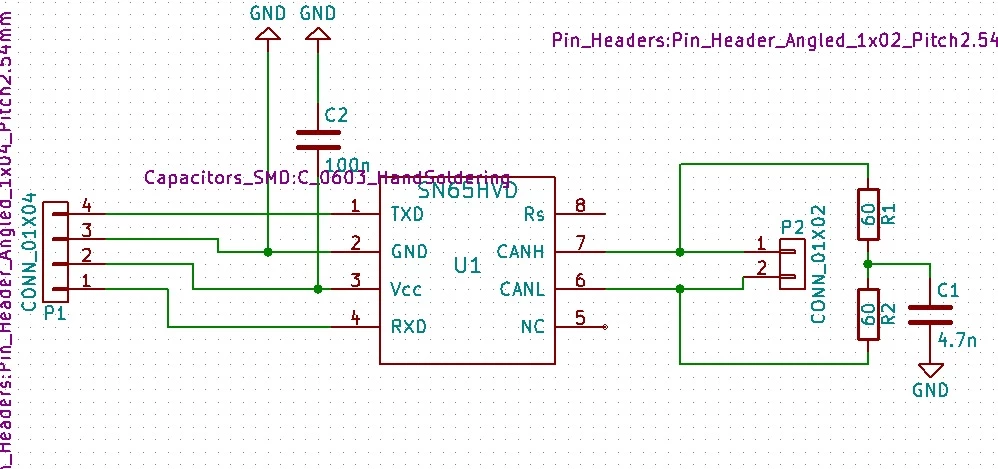

2) Heres schematic of CAN implementation:
On the right hand side there are Tx, Rx, GND and Vcc. Vcc is solid 3.29V. On the left there are CAN H and L. When I probe either CAN H/L I see contineus 2.3V voltage. No differential signal, nor any signal at all. At first I had problem with Vcc, that was 2.96V, under the abs.min. 3.0V. Then the voltage on these lanes was bit lower 2.1V. Why does this transreceiver transmit data to the bus side?
I am quite lost with this one. I cannot see anything wrong with my eyes.

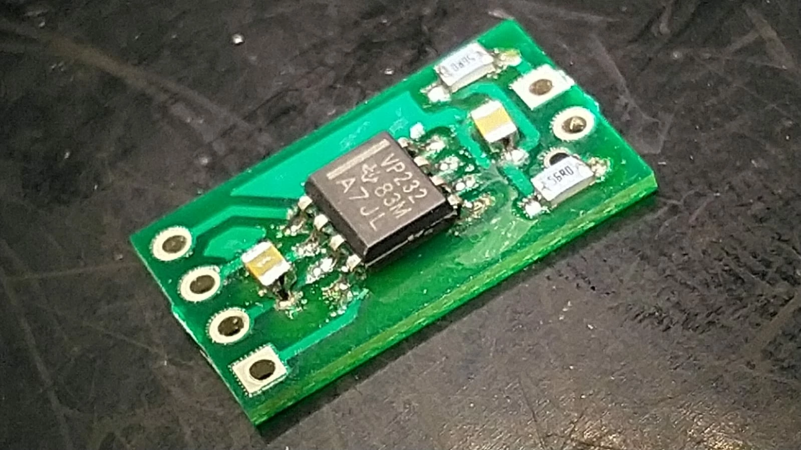

    Jun 28, 2018 7:17 PM UTC
    Posted on June 28, 2018 at 21:17
    Here is a picture of this marvelous piece of HW. I haveruled every HW bug out except that TI chip itself is broken, but it was hand soldered straight from the reel so this should not be the case.
    T J
    Senior III
    Jun 28, 2018 11:53 PM UTC
    Posted on June 29, 2018 at 01:53
    SN65HVD230 and SN65HVD231:
    RS :            Mode select pin: strong pull down to GND = high speed mode, strong
    pull up to VCC = low power mode, 10kΩ to 100kΩ pull down to GND = slope control mode
    is your RS pin floating ?
    Eetu Piukkula
    Jun 29, 2018 8:46 AM UTC
    Posted on June 29, 2018 at 08:46
    Yes, that pin is not connected. But that does not matter since I am using SN65HVD232. That version does not support slew rate control.
