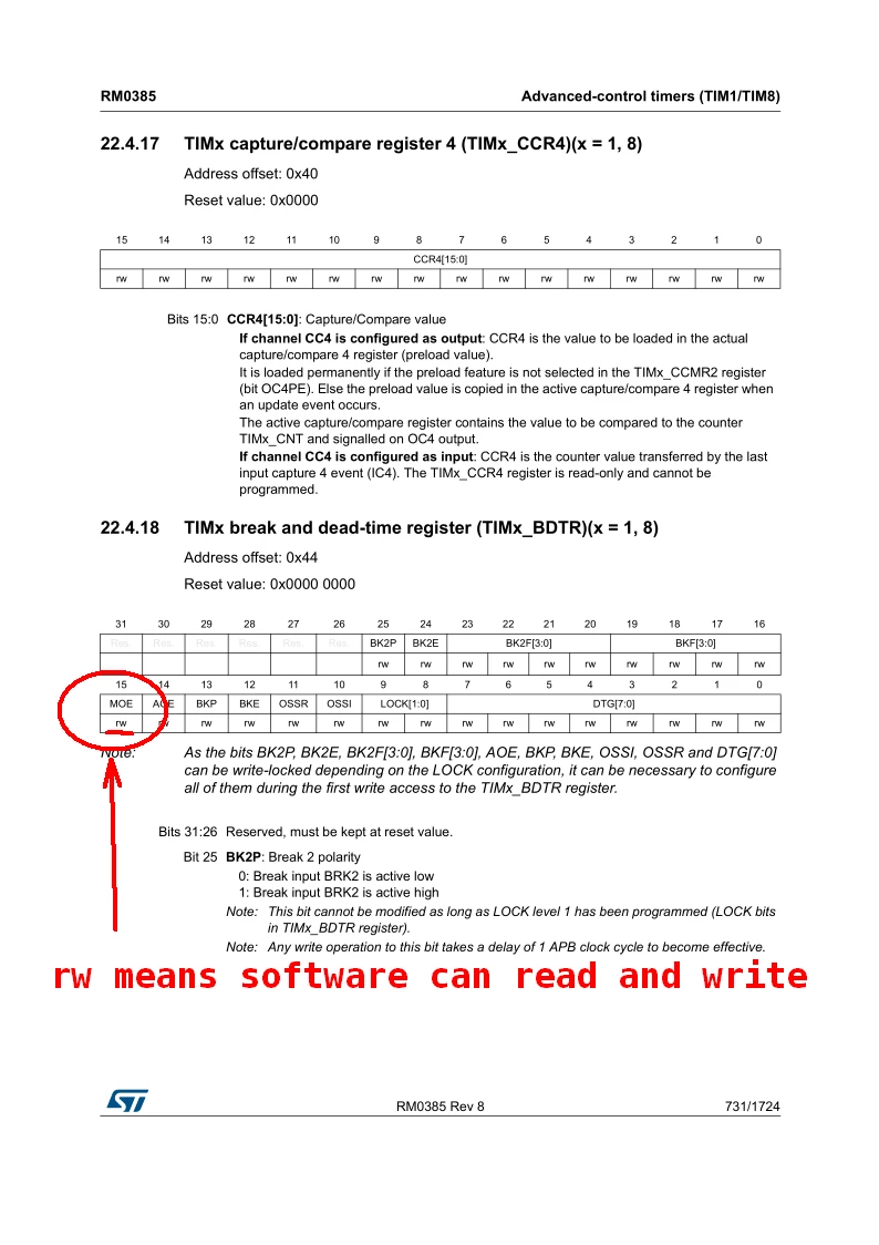

Doesn't using CHx from advanced timer require to enable it also by setting TIMx_BDTR.MOE?

Not sure what to say, the datasheet says MOE not directly writeable. Anyway, readback does show MOE on. Or, perhaps there is some nuance I'm not getting.
Then you must have a different datasheet (here: Reference Manual) than I have.
Anyway - read out and check all TIMx registers. Check that it's running and generating a waveform on the given channel - assign it to an appropriate pin in GPIO and observe using oscilloscope.
Read out also the ADC registers and check if they are properly set.
