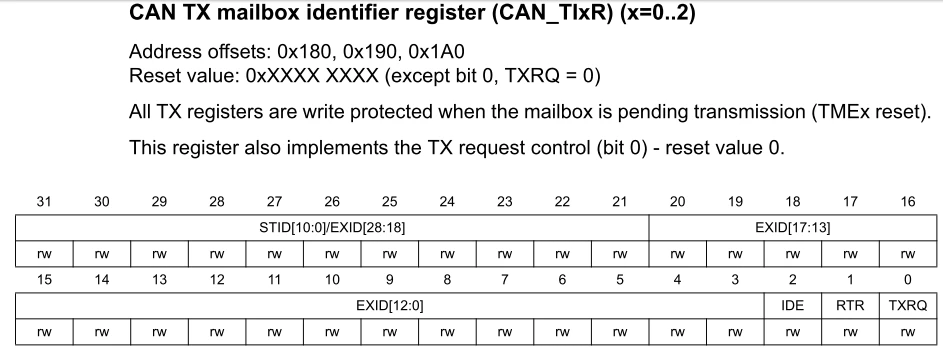

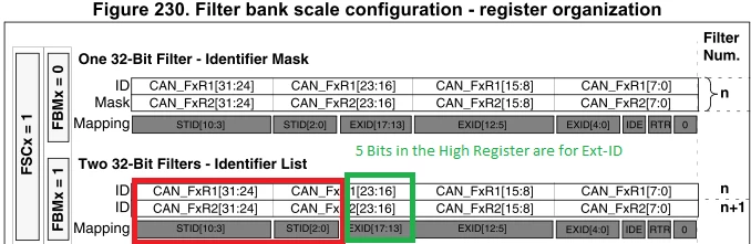

    JSzuc
    Apr 10, 2019 8:28 PM UTC
    Hi Szymon!
    I try the example on an stm32f103c8t6 and its working fine, but I cant change the filter config to "_IDLIST", Its simply not work anymore in any combination of the mask and id… May be I missed something...
    Regards.
    J.
    RAlex
    Visitor II
    Jul 1, 2019 10:21 AM UTC
    Hi szja681.5541402147734006E12,
    I began recently with Microcontroller and STM32 and I stumbled over the same issue.
    If you are using a standard-ID ( CAN_TxHeaderTypeDef TxHeader; TxHeader.IDE = CAN_ID_STD;)
    and Filterscale 32Bit (sFilterConfig.FilterScale = CAN_FILTERSCALE_32BIT;)
    you have to shift FilterIDHigh and FilterMaskIdHigh by 5 Bits to the left.
    E.g.
    sFilterConfig.FilterIdHigh = 0x0123<<5;
    sFilterConfig.FilterMaskIdHigh = 0x0123<<5;
    This is IMO due to the register in the Tx Mailbox.
    Here is picture from the STM32F103 Reference Manual .
    As you can see the Std-Id is from [31:21].
    If you don't shift the Filter ID the comparison will fail.
    Because the STD-ID is left justified in the comparing Mailbox.
    Here is a pic from the register Organisation.
    Mapping is your Mailbox register.0690X000009YEoEQAW.pngI hope this will help someone.
