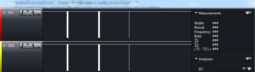

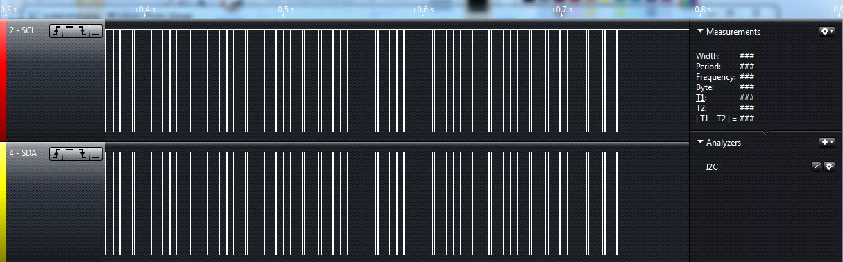

Hello all,
I'm attempting to talk to two devices, a barometer (MS5611) and a magnetometer (HMC5883L), using I2C with DMA on an STM32F4. The barometer runs on a timer (10ms), while the magnetometer runs through an interrupt line.
The slaves work well together, communicating only when the other isn't as verified by a logic analyzer. However, occasionally (~ every 20 secs), when the MCU attempts to write to the barometer the start condition is immediately followed by a stop condition. No address is sent, it is a void message! I have attached pictures below.
I2C working nicely until the last part:
Zoom in on the last three communications. The first is a barometer write followed by read. The second is a magnetometer interrupt triggering a write followed by read. The last is the faulty barometer communication.

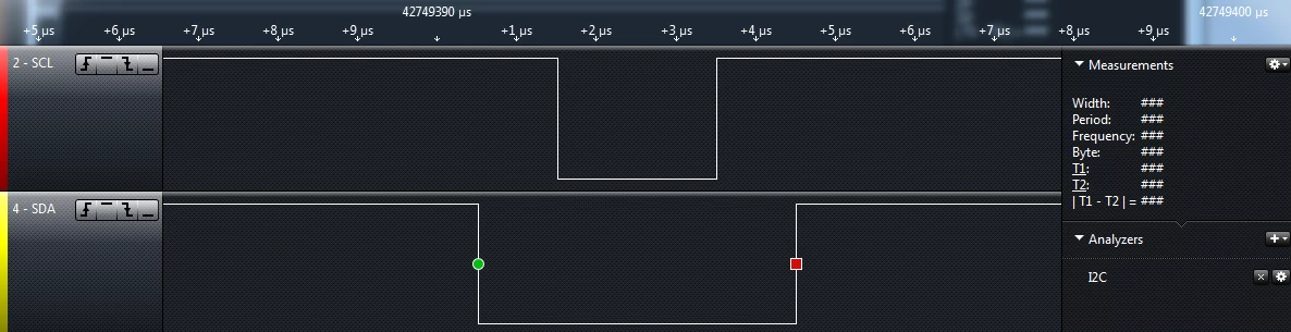

This is a close-up of the last faulty communication. You can see that SDA is low for 4us, which is slightly longer than usual.
This issue causes the I2C to timeout at the I2C_WaitOnMasterAddressFlagUntilTimeout function.
I do not believe this is associated with DMA as I am using CubeMX code, where the Addressing phase occurs before any DMA communication.
I have also tried adding an EEPROM (4FC128) as a third slave. The eeprom exhibited the same problem. Only the Magnetometer does not exhibit this, making me think it might be causing the problem?

Some more details:
- The microcontroller is a PX4FMU.
- No error shows up in the i2c register when placing a breakpoint at the timeout. Perhaps it is cleared before I can see it?
- This happens with and without enabling clock stretch
- This happens for I2C both speeds of 400kHz and 100kHz
- There are external resistor pull-ups on the PX4 of 1k5.

I have found the the reason why writes are failing. Sometimes (every 10 - 20 thousand bus transactions (every 20 seconds or so), the STOP bit in the CR1 register is not cleared.
Then when the new read or write is initiated, the START bit is set in CR1, but the STOP bit is also still set.
I can prevent these null messages on writes by clearing the STOP bit before setting the START bit. I am not using DMA and so:
static HAL_StatusTypeDef I2C_MasterRequestWrite(I2C_HandleTypeDef *hi2c, uint16_t DevAddress, uint32_t Timeout)
if(I2C_CR1_STOP & hi2c->Instance->CR1)
//disable stop
hi2c->Instance->CR1 &= ~I2C_CR1_STOP;
  /* Generate Start */
  hi2c->Instance->CR1 |= I2C_CR1_START;
  /* Wait until SB flag is set */
  if(I2C_WaitOnFlagUntilTimeout(hi2c, I2C_FLAG_SB, RESET, Timeout) != HAL_OK)
    return HAL_TIMEOUT;
does the trick.
