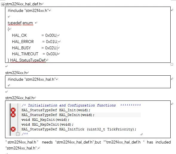

�?stm32f4xx_hal.h�? needs “stm32f4xx_hal_def.h�?,but "�?tm32f4xx_hal_def.h “ has included “stm32f4xx_hal.h“.

    There are some cross definitions, however, compiler will successfully work. Some of the #include within a header file are not placed at the top of the file.
    Most headers are recurse protected either by compiler preprocessor (we have past the jurassic period), or simply by the
    #ifndef _THIS_HEADER_FILE_
    #define _THIS_HEADER_FILE_
    #include "againthisone.h"
    #endif...

    the point is sequence。Under these conditions,compiler will ​compile stm32f4xx_hal.h first。but the defined structure:HAL_StatusTypeDef is in stm32f4xx_hal_def.h。like recurse

    You must call out the modules you want to include via defines in stm32f4xx_hal_conf.h in your project. Review the template projects.
