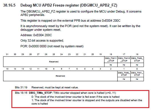

STM32F4VET6 DMA ADC half callback after buffer is full
So,I set my DMA at circular mode ,adc at continuous mode ,but when I debug the timing to get into HAL_ADC_ConvHalfCpltCallback(),I found the buffer is already fulled,can someone tell me what's going on?
mƎALLEm
mƎALLEmBest answer
April 11, 2024
Because it's not possible to stop ADC while debugging. See this thread.
The only solution I see, is to trigger the ADC with a timer and freeze its counting when the CPU is halted. This is done by writing to DBGMCU_APB2_FZ register:
See this thread.
Hope it helps.
