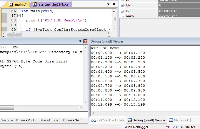

Tesla DeLorean
Guru
April 1, 2014
Posted on April 01, 2014 at 04:31
This works for me in Keil,

/* Calendar Configuration with HSE/8 supposed at 1 MHz */
RTC_InitStructure.RTC_AsynchPrediv = 125 - 1;
RTC_InitStructure.RTC_SynchPrediv = 8000 - 1; /* (1MHz / 125) - 1 = 7999*/
RTC_InitStructure.RTC_HourFormat = RTC_HourFormat_24;
RTC_Init(&RTC_InitStructure);

printf(''RTC HSE Demo
if (SysTick_Config(SystemCoreClock / 1000))
printf(''SysTick setup failure
/* Capture error */
while (1);
RTC_Configuration();
#define DELAY 1100
while(1) // Do not exit
RTC_TimeTypeDef RTC_TimeStructureA, RTC_TimeStructureB;
uint32_t subsecondA, subsecondB;
uint32_t MilliSeconds;
do
subsecondA
RTC_GetSubSecond
(); // 0..7999
RTC_GetTime(RTC_Format_BIN, &RTC_TimeStructureA);
subsecondB
RTC_GetSubSecond
RTC_GetTime(RTC_Format_BIN, &RTC_TimeStructureB);
while((RTC_TimeStructureA.RTC_Seconds == RTC_TimeStructureB.RTC_Seconds) && (subsecondA == subsecondB));
MilliSeconds = ((7999 - subsecondB) / (8000 / 1000));
printf(''%02d:%02d.%03d'',
RTC_TimeStructureB.RTC_Minutes,
RTC_TimeStructureB.RTC_Seconds,
MilliSeconds);
// Predict Next expected MM:SS.sss
MilliSeconds += DELAY;
while(MilliSeconds >= 1000)
MilliSeconds -= 1000;
RTC_TimeStructureB.RTC_Seconds++;
if (RTC_TimeStructureB.RTC_Seconds >= 60)
RTC_TimeStructureB.RTC_Seconds -= 60;
RTC_TimeStructureB.RTC_Minutes++;
if (RTC_TimeStructureB.RTC_Minutes >= 60)
RTC_TimeStructureB.RTC_Minutes -= 60;
printf('' --> '');
MilliSeconds);
printf(''
DelayMs(DELAY);
