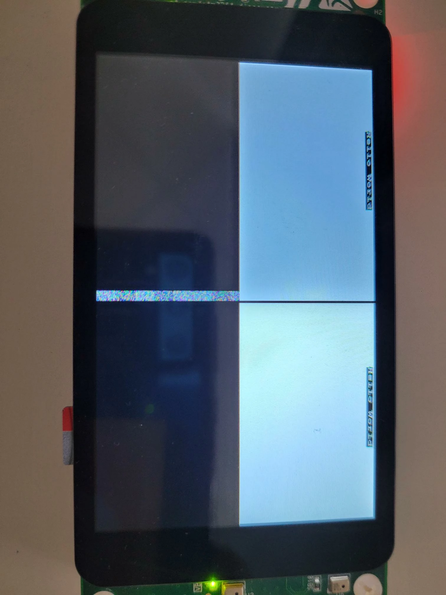

I'm currently trying to program an STM32F469I-Discovery REV-B-01. I'm using the BSP files from STM32Cube_FW_F4_V1.28.0.
What I want: Just a white screen with "Hello World" at the top.
What I'm facing: Look at the picture.
This is my Code:
 BSP_LCD_Init();
 BSP_TS_Init(800,480);
 BSP_LCD_LayerDefaultInit(0, 0xC0000000);
 BSP_LCD_SelectLayer(0);
 BSP_LCD_DisplayOn();
 BSP_LCD_Clear(((uint32_t) 0xFFFFFFFF));
 BSP_LCD_SetBackColor(((uint32_t) 0x00000000));
 BSP_LCD_SetTextColor(((uint32_t) 0xFFFFFFFF));
 sFONT *myfont = &Font24;
 BSP_LCD_SetFont(myfont);
 BSP_LCD_Clear(LCD_COLOR_BLACK);
 BSP_LCD_DisplayStringAt(0, 0, (uint8_t *)"Hello World", 0x01);

Hello @DerFreaker ,
May be this example provided in the STM32CubeF4 firmware package help you: STM32Cube_FW_F4_V1.28.0\Projects\STM32469I-Discovery\Applications\STemWin
Please check the application note AN4323 for detailed steps on using the STemWin library.
Thank you.
