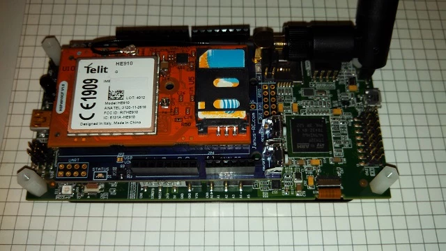

Back view
With Cellular Modem

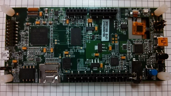

Oct 15, 2015 2:56 PM UTC
Posted on October 15, 2015 at 16:56
I have a pair in my hand as I write..

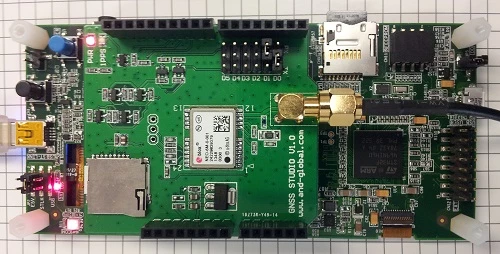

Oct 19, 2015 8:05 PM UTC
Posted on October 19, 2015 at 22:05
I have the USART3 PB10/11 working as the VCP on the ST-LINK of the DISCO at 115200 8N1
Have the microSD card up and running. Quick test delivered 6.5 MBps Write, 11.2 MBps Read (Verbatim Class 10/U1).

1000x 32KB blocks through FatFs

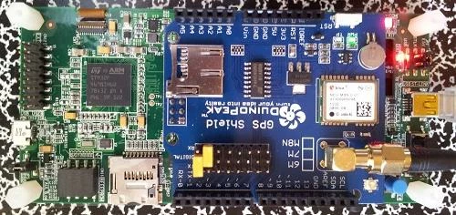

Posted on October 22, 2015 at 22:58
Arduino shield connector works well. D0 USART6_RX PG9, D1 USART6_TX PG14
LEDs at PG6, PD4, PD5, PK3
Here with a GPS shield
Need to port my CORS-LITE RINEX file recorder over to the board, and add a graphical interface with the display.
Added SDRAM initialization code, 32-bit wide, tested 16MB
https://www.micron.com/~/media/documents/products/data-sheet/dram/128mb_x32_sdram.pdf
