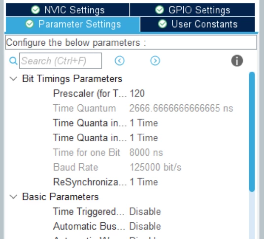

Hi all,
               I am trying to establish a CAN communication between stm32f469i and PC.  I have used Cube MX to generate CAN driver.  I am not getting any data from the stm32f469i. I have also attached code for the reference.

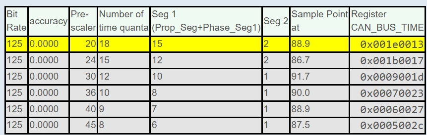

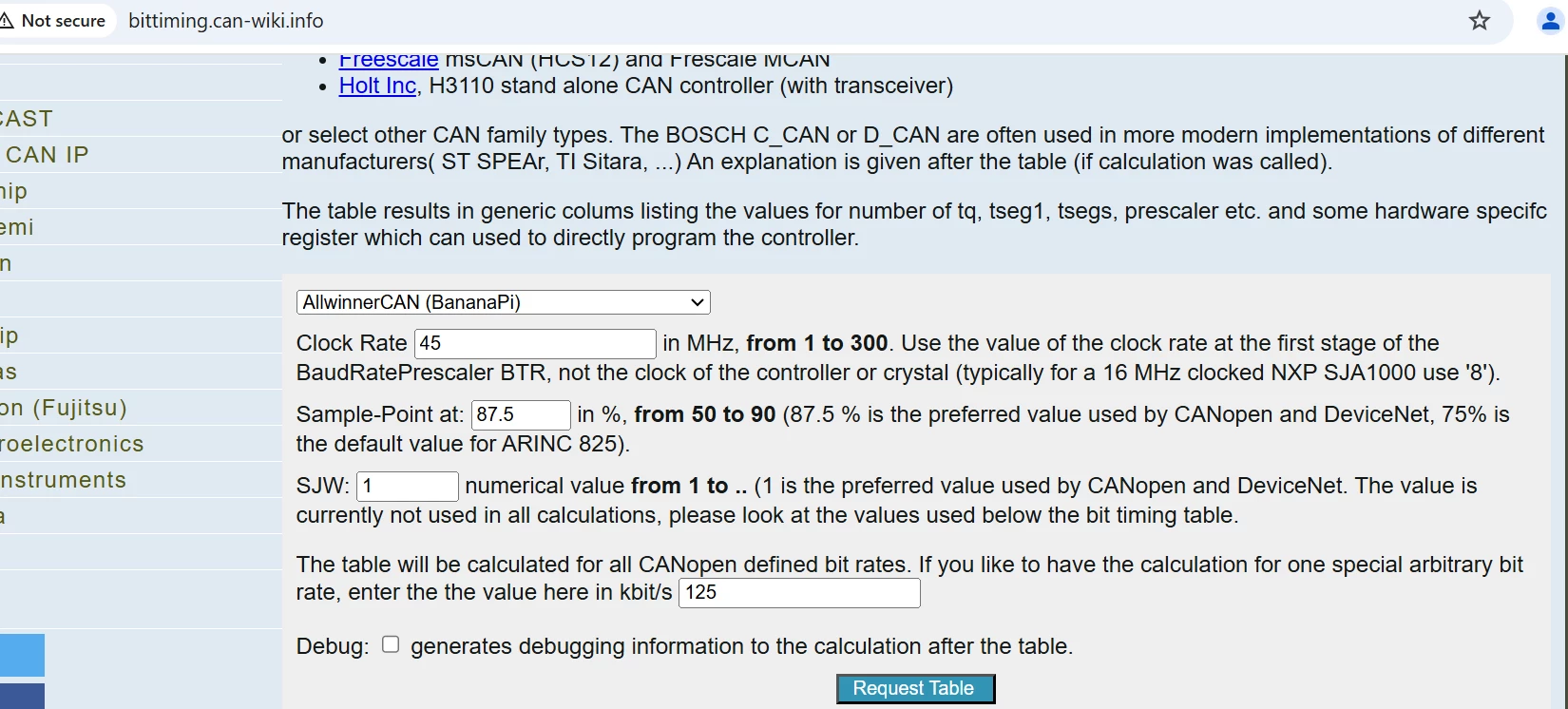

This is not a setting that is recommended. The sample point is between Seg1 and Seg2, and should be at about 75% to 90% (CanOpen has normaly 87.5%). Please us a Can Bus timing calculator (for example http://www.bittiming.can-wiki.info/ ) to get better timing parameters.

Did You set the apropriet bitrate in CubeMX?
in MX_CAN2_Init() the settings are strange:
 hcan2.Instance = CAN2;
 hcan2.Init.Prescaler = 120;
 hcan2.Init.Mode = CAN_MODE_NORMAL;
 hcan2.Init.SyncJumpWidth = CAN_SJW_1TQ;
 hcan2.Init.TimeSeg1 = CAN_BS1_1TQ;
 hcan2.Init.TimeSeg2 = CAN_BS2_1TQ;
mvpAuthor
Jan 11, 2025 2:10 PM UTC
              Thanks for your response. Yes the bit rate was configured as 125000 bps.

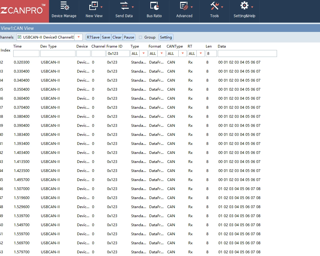

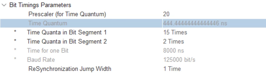

    Thanks for your valuable support. As you have suggested configured Seg1 and Seg2 from http://www.bittiming.can-wiki.info/
Now it is working Perfectly :
Also attached the updated code. Thank you once again .
