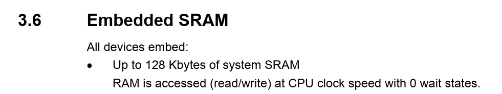

STM32F466RE: How many clock cycles to access data sram memory?
For application benchmarking, I would like to access the data memory of the STM32F466RE in a single cycle.
What is the data load latency of the STM32F466RE from data SRAM at 84MHz?
and, if it is not single cycle, can I reduce the core frequency to decrease the number of SRAM access cycles?
Thank you.

see ds:
