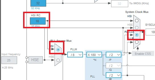

In other hand, please avoid HSI for the CAN communication in Normal mode. You have this from “CastletRestart” side:
Also avoid low BSx values for the CAN bit time setting such as BS1=BS2=2.
