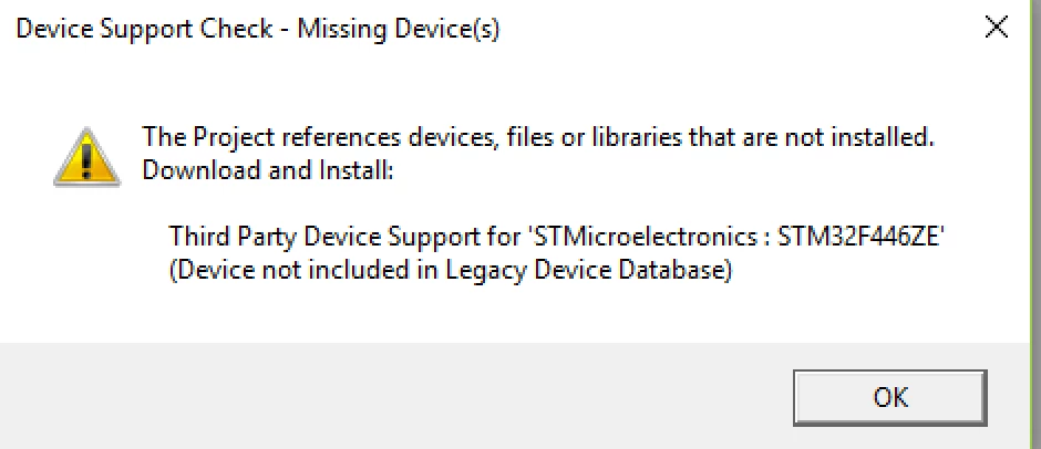

stm32f4xx_rcc.c(2729): error:
#20: identifier 'RCC_BDCR_LSEMOD' is undefined
Does anyone have a good CDB file or the Device data/text for the STM32F446xxx MCU?
I have an MDK-ARM uVision v4 project which was made for the STM32F405/407 in 2012. It was made with the 'DSP and Standard Peripherals Library�?, (“SPL�?) v1.01.  I have been able to rebuild it using the ARM Keil MDK/uVision which works fine, and I've managed to do that with both uVision v 4.72 and with v 5.23 (which is current). Next, I need to retarget it to the STM32F446 MCU.
I can also spontaneously create this problem if I go into Cube MX, generate the code in a MDK-ARM uv4-format project. Note that I'm not needing to Build... Just to go to see that the MCU I want is targetted. Indeed, when I do this for the STM32F446ZE, then open the project in uVision 5, I get an error alert on the screen:
It says:
“The Project references devices, files or libraries that are not installed. Download and Install:  Third Party Device Support for ‘STMicroelectronics: STM32F446ZE’ (Device not included in Legacy Device Database)�?

I’m under the impression that in uVision, (4 or 5) I need to set the Target Device to the STM32F446ZE. But it doesn’t exist in the Device Database. I can add it with either a CDB file which contains data about its characteristics, or I can manually enter the text data in a GUI.
To change the target 'Device' in uVision: If I use uVision v5.23, its support for the STM32F446 comes from the Device Family Pack for STM32F4 Series, v2.11.0 (2016-12-07); it's a 'DFP' or 'Pack'. Unfortunately, selecting the STM32F446ZETx from the DFP brings with it the forcing of the Pack's CubeF4 Libraries. By my understanding the Cube Libraries/HAL/LL BREAK the SPL. Indeed, the Build-All which works fine with the previously-selected v4 Device selection: STM32F407,  FAILS due to the Cube libraries' inclusion. None of the normal places to go in the project options, group, or file options can GET RID OF the includes for the Cube libraries.
Under the hood, uVision v5 actually has TWO DATABASES for 'Devices'.  The newest and current one is built around the DFP's or Packs. Then there is the earlier database which is still supported for the Devices which come along from v4. The very highest numbered STM32F4 series MCU that is included is the STM32F439. I did some web searching and found an article which said that I could get support for the STM32F446 under the older system by adding their 'Legacy Cortex-M4 Support'. This is supposed to add to the Device Database a number of MCU's which are newer than what MDK-ARM v4 included when it was released. But even after doing this there was no Device in the database for the STM32F446.
From that point I went on to read other articles about how you can add support for new Devices to the v4-style, older Device Database either with a CDB file you find from someone, or create interactively in a GUI the new Device. I followed these procedures to make a Device for STM32F446ZETx, based on the STM32F405 with certain changes which seemed obvious. I gave it all a go, doing Build All (but still with the SPL v1.0.1), and the results were positive. But I don't have confidence yet in the Device I defined/created for the STM32F446ZETx.  I'd far prefer to find an official one which is more likely to be correct than mine.
