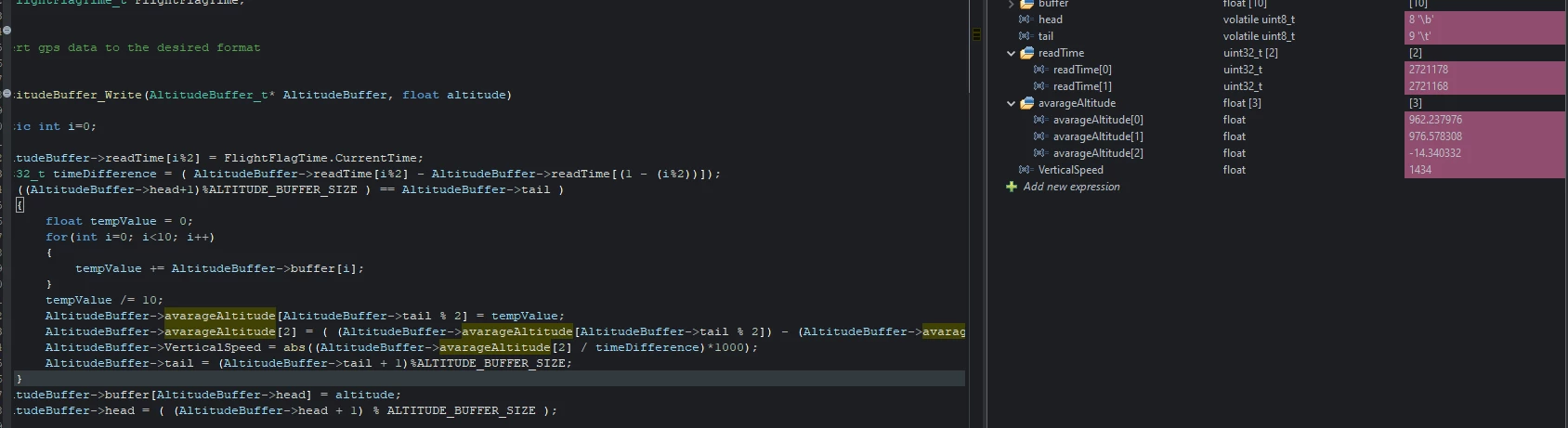

Okay, showing all variables, good, but you've cropped it so we can't see where execution is at when those expressions are evaluated. Note that "tail" is also modified in the given code. Set a breakpoint at the "AltitudeBuffer->avarageAltitude[2] =" line, and step over. If you do that, only the "AltitudeBuffer->avarageAltitude[2]" will show up with a red background, instead of everything, indicating it (and only it) was changed since the last break.

Let's be objective here. The processor is unlikely to be performing math incorrectly. It's handled in hardware by the core, which is used by millions of people and doesn't have glaring issues. Similarly, the compiler is also widely used and is unlikely to be creating the incorrect assembly code. So what's left?
  • Perhaps you are mistaken in what values are what. Try to capture everything in a screenshot rather than cut/paste which is subject to translation errors.
  • Perhaps this is a temporal issue. Put a breakpoint after the "invalid" statements are executed and show the values in the expression window.

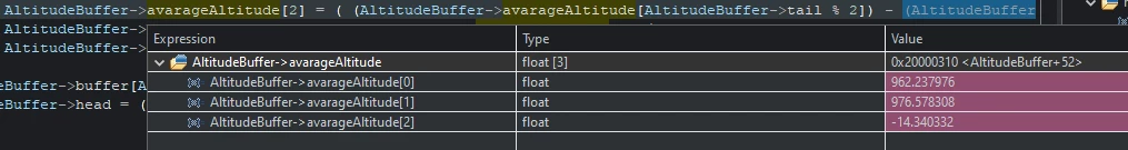

Aug 26, 2024 3:22 PM UTC
Hi TDK,
Thank you for answering
Tail is = 9
it means Tail%2 = 1
AltitudeBuffer->avarageAltitude[AltitudeBuffer->tail % 2]
means = AltitudeBuffer->avarageAltitude[1]
and
AltitudeBuffer->avarageAltitude[1-((AltitudeBuffer->tail) % 2)]
means = AltitudeBuffer->avarageAltitude[0]
AltitudeBuffer->avarageAltitude[0] = 962.237976
AltitudeBuffer->avarageAltitude[1] = 976.578308
AltitudeBuffer->avarageAltitude[2] = AltitudeBuffer->avarageAltitude[1] = 976.578308 - 962.237976 = 14.340332
But I got -14.340332
With screen shots :

Aug 26, 2024 6:35 PM UTC
Hi TDK, Thank you for answering
I did what you said and you are right. When I add a breakpoint at this 3 lines I see it clearly.
Now tail is 7 and tail%2 = 1
its gonna be >> 0.19411011 - 0.251983643 = -0.0578735322
I am gonna try to fix that
Aug 26, 2024 6:58 PM UTC
Glad you figured it out.
Always good to simplify things when debugging to isolate the error. As a general rule, it's incredibly unlikely that the core or the compiler is the source of the issue. If you suspect one of those, try to prove it with a simple program and screenshots. Usually that convinces you otherwise and helps you find the misunderstanding. Works well for me anyway.
waclawek.jan
Aug 26, 2024 4:52 PM UTC
You change tail after the subtraction. When the difference was calculated, tail was 8.
