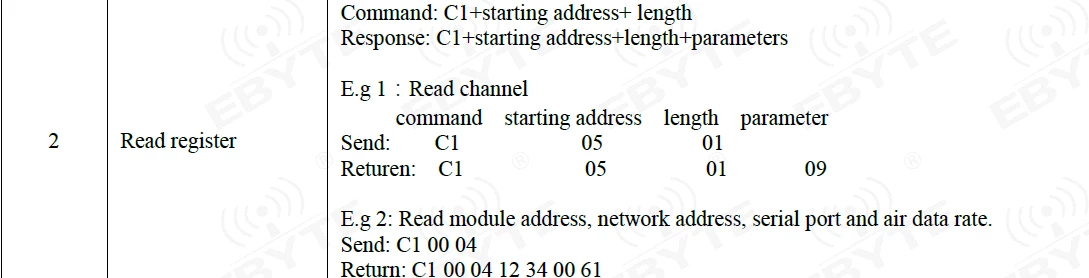

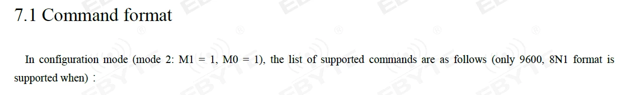

In the LoRa E220-400T30S documentation, it tells me to set the UART settings for configuration mode to 9600 and 8N1 and to give 1 to M0 - M1 pins.
After doing that I am trying an exampe in below of the document

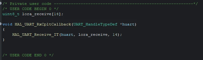

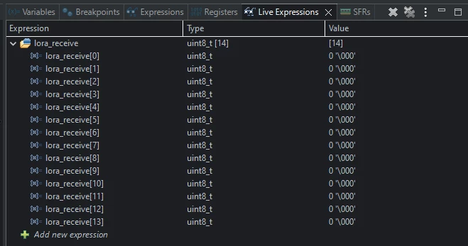

I am sending "C10004" and I have an interrupt for receive function for RX. But I got nothing in buffer...
I'm using UART for the first time, so I can't even guess what I'm doing wrong. I would be very grateful if you can help me.

Send as three bytes not as an ASCII string

Is the UART RX interrupt actually triggered? You will be able to check with debugger breakpoint or onboard LED.
If interrupt is not triggered, check the NVIC configuration, likes HAL_NVIC_EnableIRQ().
Make sure interrupt handler can call the HAL driver's callback. HAL_UART_RxCpltCallback function is executed by the UART interrupt handler:
void USART1_IRQHandler(void)
 HAL_UART_IRQHandler(&huart);
(examples are about USART1. You need to find an interrupt handler suitable for your hardware.)

I did it after posting this nothing changed still not working :(
