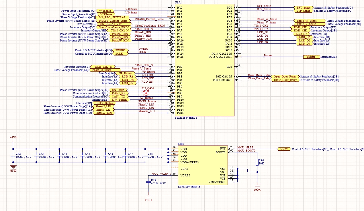

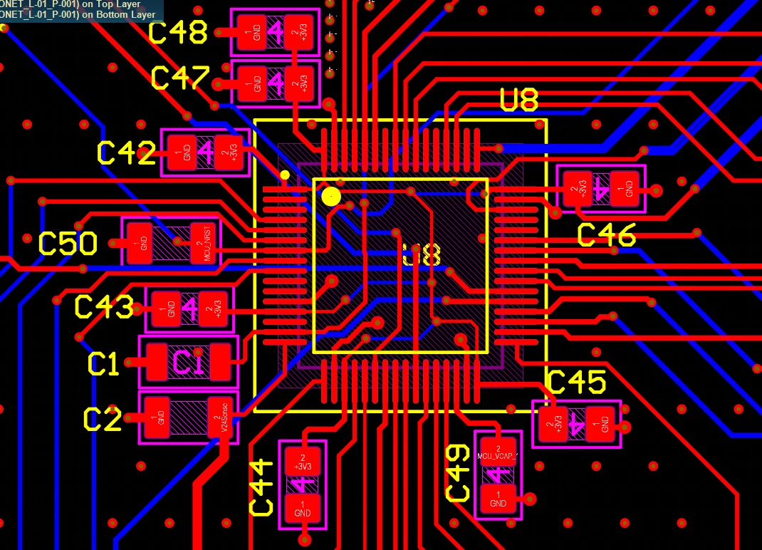

  6. Could you please review the attached schematic and PCB layout and let me know if you see anything incorrect?
I have attached the schematic, PCB layout, and relevant measurements for your review.

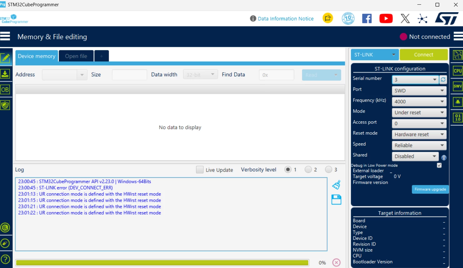

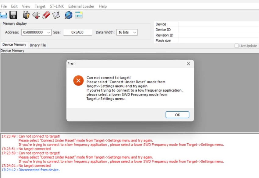

Your first screenshot shows the long-obsolete ST-Link Utility, which you can safely ignore as it was replaced a very long time ago by the STM32CubeProgrammer, which can be seen in the second screenshot.
Please ensure that you are using a genuine ST-Link/V2 and not one of those colourful, illegal counterfeits in the form of brightly coloured tin cans. See the relevant article in the Knowledge Base for more information:

Aug 22, 2026 9:44 AM UTC
Thank you for the detailed information.
I understand your point regarding the obsolete ST-Link Utility and the importance of using a genuine ST-Link. For my tests, I am using the embedded ST-Link/V2-1 from a genuine STM32 Nucleo-64 board, connected to my custom STM32F446RET6 board for external programming/debugging, as described in UM1724.
I have also tested the board with STM32CubeProgrammer, and the result is the same.
However, I believe the main issue is not the ST-Link itself. The problem I am trying to investigate is the VCAP1 voltage:
  • VDD = 3.3 V stable
  • VDDA = 3.3 V stable
  • VCAP1 = approximately 0.4–0.6 V, then it drops
  • STM32CubeProgrammer cannot connect to the MCU

Where are these documents: “I have attached the schematic, PCB layout, and relevant measurements for your review.”
Aug 22, 2026 9:42 AM UTC

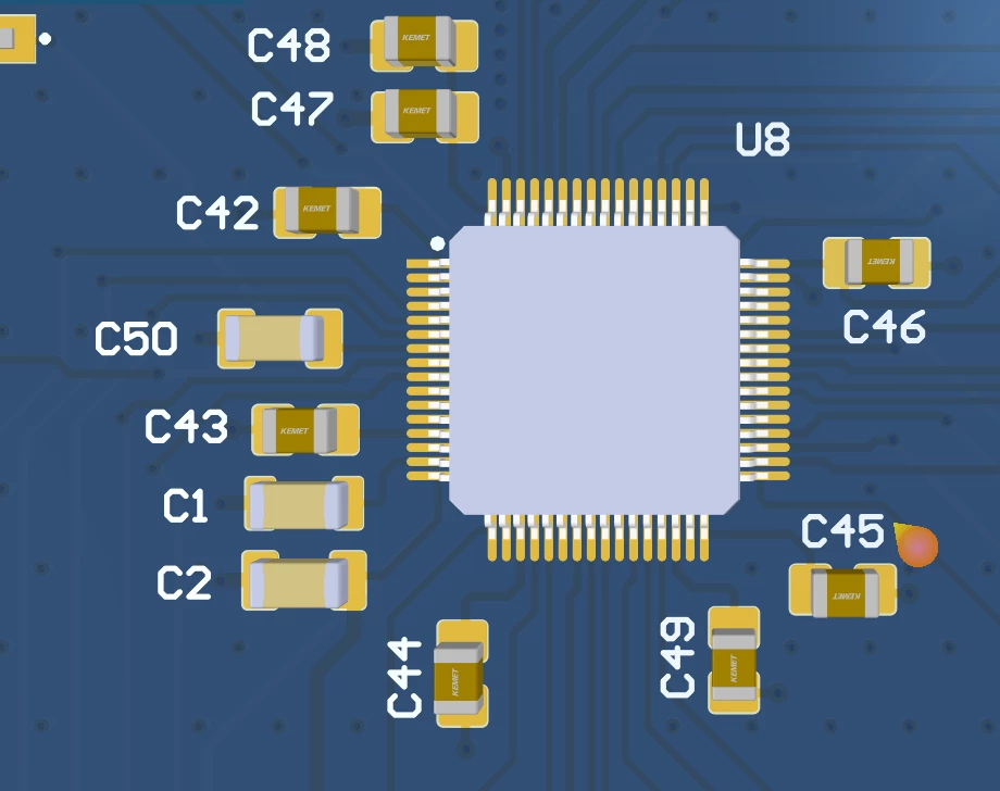

  1. have a photo of the chip soldered . We have seen some designs where the pin 1 position is flipped by 90 degree.

  3. looking to the footprint of C49 I have some  doubt if the value is 4.7uF if possible to measure . A a double check is always good .

Regarding the MCU orientation and footprint, I have checked this carefully. The MCU is soldered with Pin 1 correctly positioned on the left side, and the pin numbering proceeds counterclockwise, matching the STM32F446RET6 datasheet/package orientation.
So far, the VCAP capacitor and MCU orientation have both been double-checked.

If you have an email address where I can send the PCB design files, schematic, and PCB layout, I can provide them. Having the actual design files may make it much easier to identify any PCB or connectivity issue causing this behavior.

Could you provide a photo of the package  and top marking soldered on PCB ?
Thank  you.

Check gerber files, the pin 12 to GND only one VIA, please measure the PIN 12 to GND connection. Other looks OK.

Serial number of “3” is not a valid serial number. Probably the programmer is fake.
Voltage of “0 V” is not within bounds. Most (but not all) genuine programmers require V_target connected.
Orientation may be off. Show a picture that lets someone else verify correctness. Maybe it’s right, maybe not.
Schematic is missing programming connection. Maybe it’s right, maybe not.
