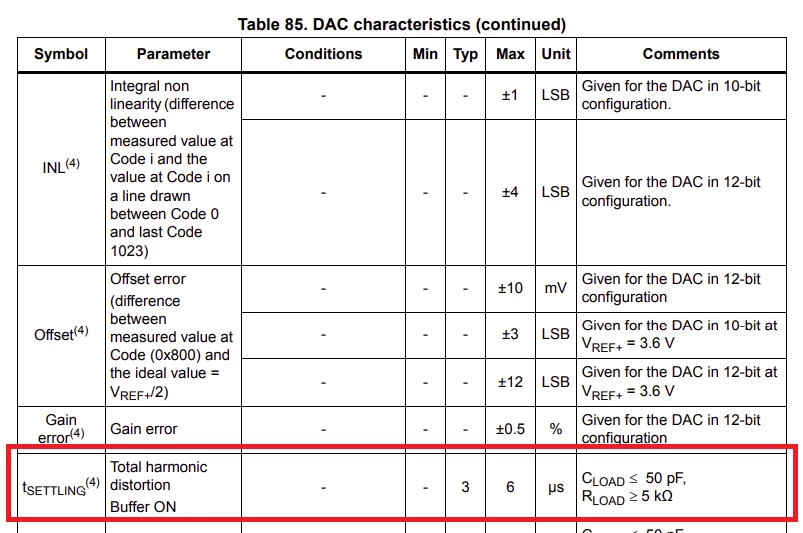

I want to generate a bipolar square wave with a pulse width of 100us per phase using the DAC in STM32F446RET6.
But when I measured the DAC output (PA4), I found that the DAC output was not an ideal square wave, but a trapezoidal shape with a long rise time. However, according to the STM32F446RET6 manual, the DAC conversion time should be only a few microseconds. I used the DMA function and triggered the DAC output via Timer 6, but there was no improvement. How can I make the DAC output as perfect as possible?

Hello @Junzhe and welcome to the ST community,
According to the datasheet, there is a tSETTTLING parameter: typical 3us / max 6us with the respect of the load characteritics (Buffer ON) as the following:
So "an ideal square wave" is something not reachable.

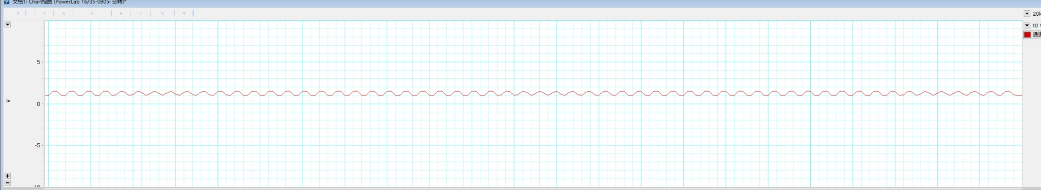

JunzheAuthor
May 14, 2025
Hi KnarfB,
I did not put a load on the output of the DAC. I connected it directly to the Powerlab for the measurement.

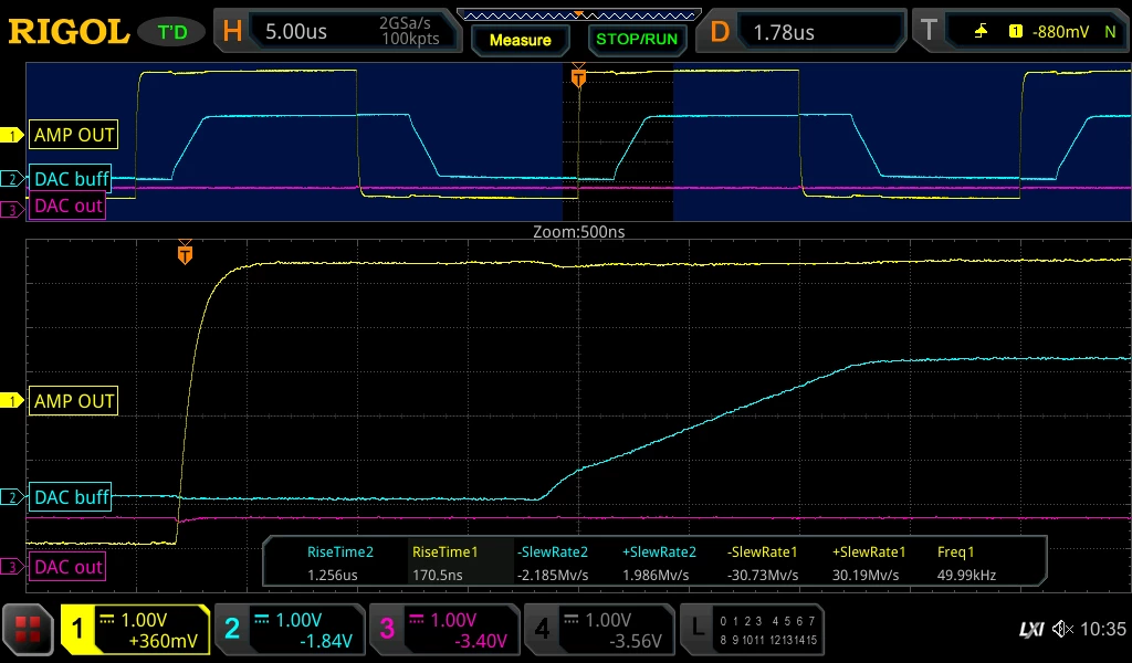

Michal Dudka
Lead
May 14, 2025
a) DAC with onboard buffer has slew rate about 2V/us (with negligible capacitive load).
b) Clarify how did you made your "scope trace" - it looks distorted
c) Consider using external buffer, then your rising and falling times can be up to ten times shorter (can be seen on following scope trace)
d) If you need realy sharp edges, consider using another method. Like DAC + analog switch etc.
Blue trace - Output directly from DAC (on board buffer)
Yellow trace - output by external buffer (LMH6612 there)
There is also appnote:
https://www.st.com/resource/en/application_note/dm00129215.pdf
JunzheAuthor
May 14, 2025
Hi Michal,
Thank you for your reply and plot. I measured the output of the DAC through Powerlab, which is similar to an oscilloscope. I connected the output of the DAC directly to it for measurement. I use the built-in buffer of the DAC in the STM32, but can't it make the output waveform as sharp as possible? If I use an additional external buffer, do I need to disable the built-in buffer?
Best,
Junzhe
Michal Dudka
Lead
May 15, 2025
What is your powerlab (DAQ ?) specs ? In other words, does it have enought bandwidth and sampling frequency to capture microseconds rise times ? It looks like the DAC is fast as it should be and you're just observing it wrong.
