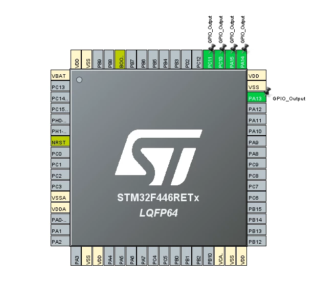

I am working with an STM32F446RE, and oddly, I am able to get one pin to set HIGH using HAL and/or direct register manipulation, but if i try to use two or more pins the debugger console prints out "Device not responding" repeatedly before shutting down. This happens with the BOOT0 pin connected to HIGH, Pulled HIGH, Floating, Pulled LOW, or connected to LOW, as well as any configuration of BOOT1. This error occurs with the HAL library or using register manipulation, and I can not seem to work past this. This occurs on both the STM32 units I am working with, what am I doing wrong?
Just to clarify, this happens with any configuration of pins, but always happens when two or more pins are HIGH at the same time. Furthermore, crashes also result when trying to send serial via the HAL library.
Thank you for your time.

Custom board? can you show the schematic and code you use to drive the pins.
i have project with the same mcu under developement and i cannot reproduce such issue.

Here is the code in main.c, and here is the board configuration. Thank you again.0693W000000ToiQQAS.png

>>..but if i try to use two or more pins the debugger console prints out "Device not responding" repeatedly before shutting down.
FFS, PA13 and PA14 are the primary debug interface pins
https://community.st.com/s/question/0D50X0000CBn6FPSQZ/target-is-not-responding-stm32-nucleof446re

JoniS asked above:
Custom board? Can you show schematics?
for a reason - suspected inadeqate power supply/ground/decoupling/VCAP.
Check (physically, suspecting bad solder joints) if all ground and supply pins are connected (including the analog ones).
