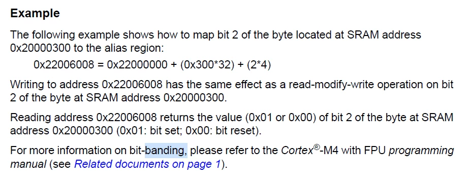

August 12, 2020
The reference manual gives a nice example of how to use the bit banding region:
FLASH is not bit banded. Only SRAM1 and SRAM2.
