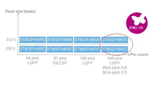

Hi Guys,
I am working on a project based on
STM32F446RE and we need to interface external SDRAM(16bit) with STM32. Can anybody help me with interface of SDRAM with STM32.

Just now, from the datasheet it seems to found STM32F446M and
STM32F446R don'tsupport FMC memory controller.
In fact yes! I already said that
FMCcontroller isavailable only forUFBGA144 andLQFP144 packages:
-Nesrine-

The document you provided was useful, but we are using WLCSP81 package(
http://www.digikey.com/product-detail/en/stmicroelectronics/STM32F446MEY6TR/497-15812-2-ND/5287184
). It seems some of the interfacing pins are not available for this package(ex:- FMC_A0 to FMC_A11). Do we have alternate pins for this or do we need to use UFBGA144(
http://www.digikey.com/product-detail/en/stmicroelectronics/STM32F446ZEH6/497-15814-ND/5287173
) package.

FMCAlternate functions are available forUFBGA144 andLQFP144 packages,please refer toSTM32F446xx pin and ball descriptions table in your datasheet for further details.

In the datasheet page no:-13 it is mentioned that
UFBGA144(
STM32F446Z
) andLQFP144(
STM32F446V)
packages only support FMC, but i dnt know why it mentions all device have embed FMC.
